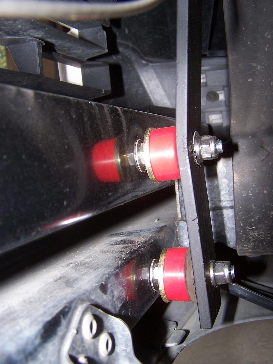

mine works pretty well. just used the poly end link bushings as a dampner and all stainless steel hardware.
That's very intuitive on the poly bushings..:bravo: I did the similar idea for my lights on the roof rack, used a diff'rent material rubber , though.

you should go to pepboys and get some of those end link bushings(under $20) like i did. it helps with the wobble effect...not 100% but certainly helps dampen the vibrations of steel on steel. I am going to make a piece that goes diagonal between the two bars to stiffen it up a bit more also.

thanks for the idea! I'm talking about right under the lip of the hood. I'll drill the bracket and install an adjustable hood stop that will rest on the top of the bumper. Hopefully, that will be enough to stop the wagging.
Right now I have a suction cup under one side and a piece of cooling hose under the other.
