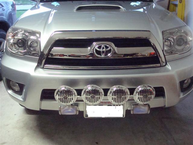

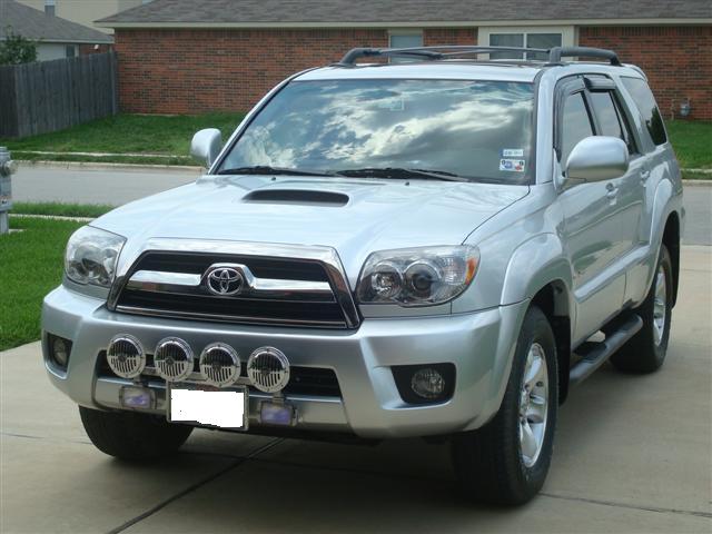

Now I removed my 4 hallogen lights to my bracket and replace it
with 4 original chrome plated bosch horn to match the chrome grill. And two fog lights.
