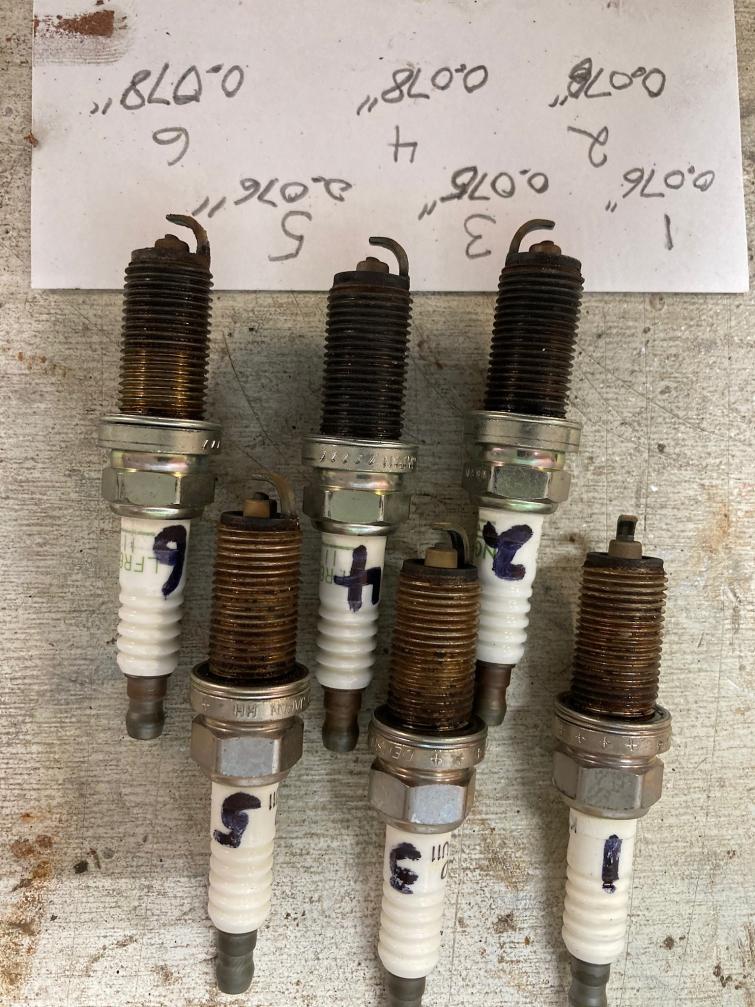

LOL. I was going to regap the spark plugs but I dont think the electrode can bend that far. They all gapped at 0.078”. They were half NGK and half Denso, so these were still the original plugs. I didnt think copper plugs could last that long. It does make me wonder what other maintenance they chose not to Do over the past 13 years.

Sounds like my truck, former owner was awful with maintenance. The plugs looked horrifically worn but man did it run better after I installed new ones of the recommended part number.
