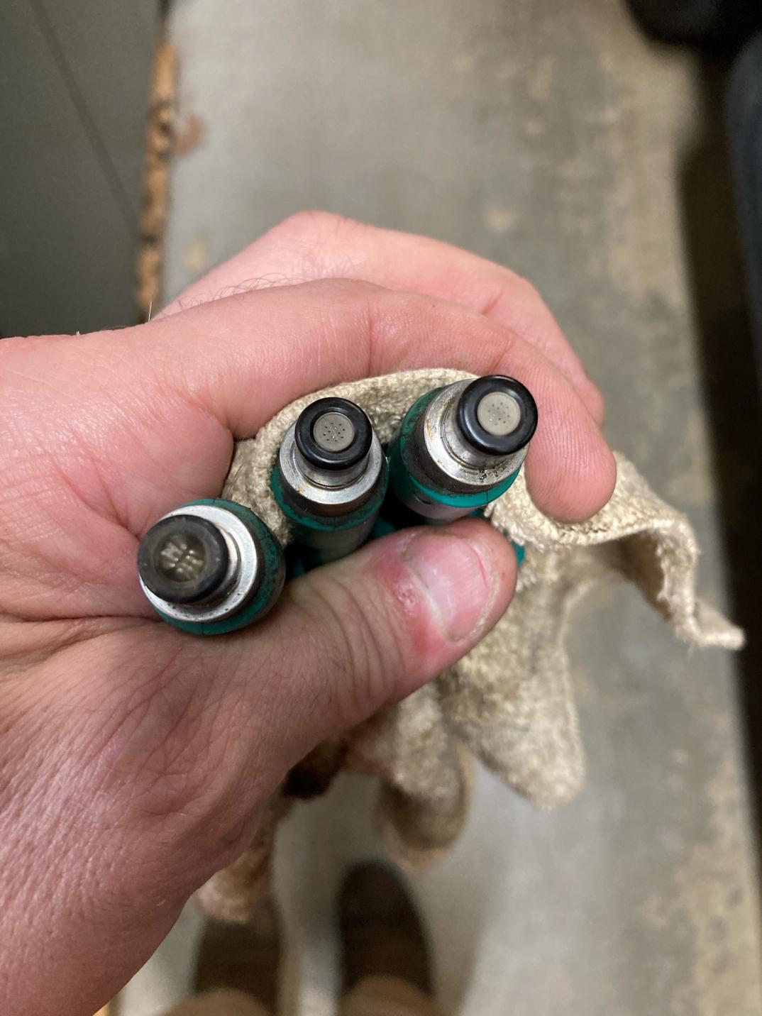

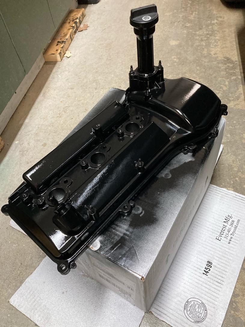

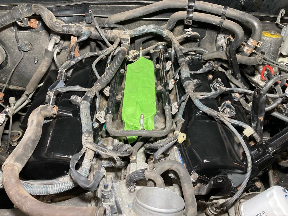

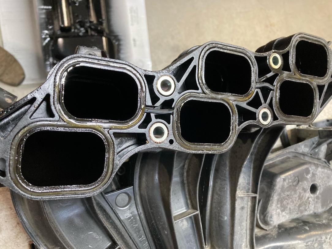

LTFT issue - I got around to removing the intake plenum and found oil escaping from between the lower intake and plenum, the gasket was compressed and rock hard. After cleaning up that mess, I pulled the drivers side fuel injectors and found 2-3 holes in the nozzles were blocked on all 3 injectors and #6 was particularly dirty. Reinstalled the new reman injectors (GB from rockauto).After looking at the oxidized valve covers, I couldnt just put them back on that way. Took some extra time, wire brushed the valve covers and sprayed them black. FYI, I have used rattle can paints that always seem to disappoint. They either come off with chemicals or just chip looking at it. I found a rattle can paint from rustoleum called Tractor and Implement paint at Tractor Supply and Menards costing $9 (pricier than others) but this paint really surprised me. Good stuff Maynard.
Reinstalled the intake plenum and new oem gasket. Went much easier than I expected, but I wasnt rushing. Net result, the BANK 2 LTFT dropped from 8% to 3.8%. Im not chasing this any longer. 4% is just fine. I think the biggest factor was clogged fuel injectors. It looked like gravel blocking the injectors and a cleaner would do nothing to fix it.
