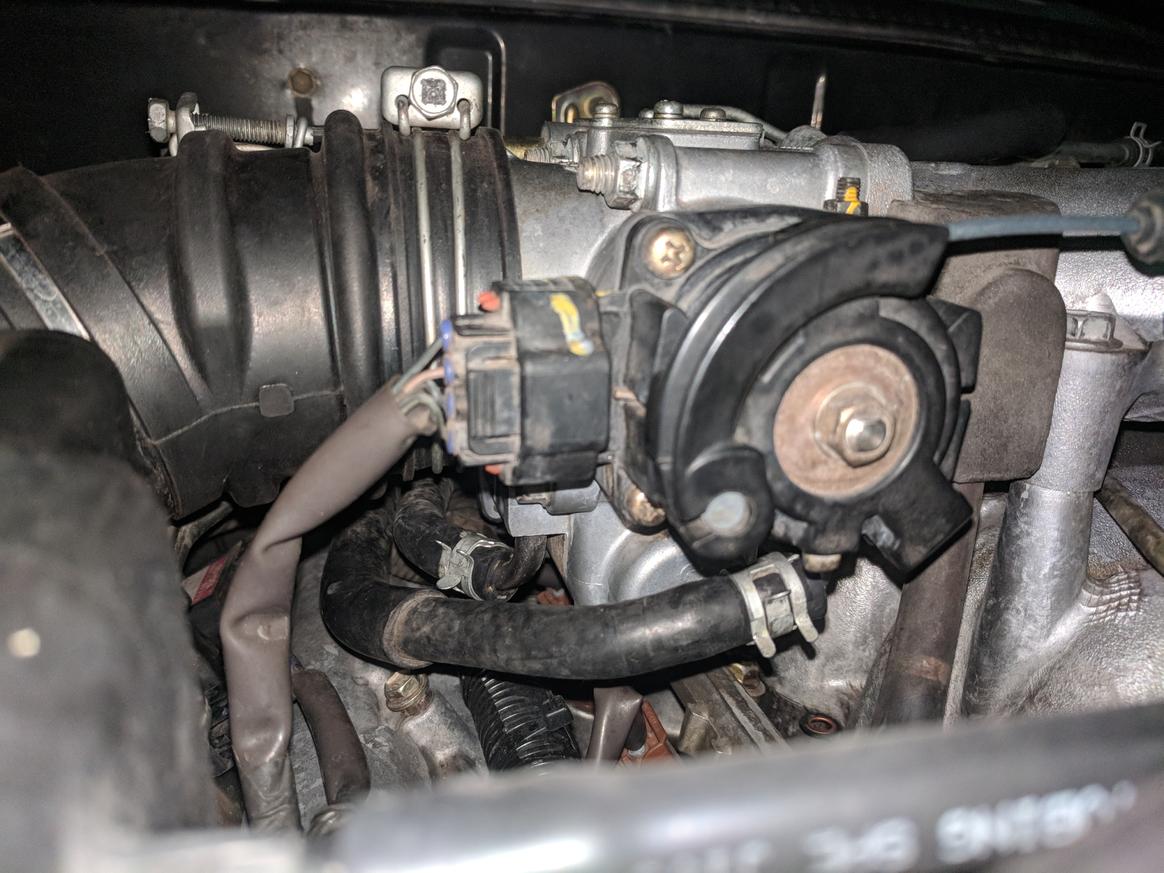

I can't start a new thread and I have looked everywhere. Where is the IAC in a 2002 4runner. I've taken off the TB and opened it up and it's all gears. No pictures or videos of the location. My throttle body doesn't look like majority of the 3rd gen 4runners out there.

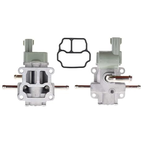

You have a 2001 or 2002 I'm guessing? They are a bit different. The IAC is on the bottom of the throttle body, only way to get to it is to remove the throttle body entirely. It looks like this held on by four brass screws:
I've taken this off. That part you have is not on my throttle body. In fact I have removed all screws to the point that I'm just looking at gears inside the throttle body. Nothing that even remotely looks like the picture.
The drive by wire throttle bodies are completely different than the older ones. I just pulled up the FSM, and there is no IAC on those type.

2001 and 2002 IAC valve is part of the Throttle body.
