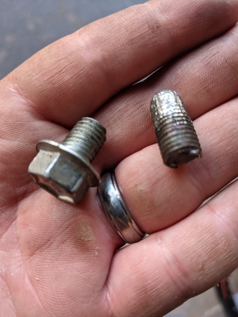

Help broke LBJ bolt with torque wrench.
Bought new 8 bolts since I agree I don't think the others are in torque spec. Don't want to mess around since this is an important part and don't want a failure.
Also bought a new torque wrench so will keep everyone posted once I undo the ball joint and try to get the stud out.
Finally got a chance to work on my rig and remove the sheared bolt.
I used vice grips but also had to disconnect the axle since it was in the way.
Thank you for all your comments and input.

If it had such little resistance that it could be turned with a screwdriver I highly doubt it would've stripped out in the first place
When you say stripped, do you mean you snapped the head or merely rounded it off? If the latter I don't see why you couldn't weld a nut to it
Bingo. Be a beast to extract.
Glad you got it out. Them deals kinda suck, but look how much you learned.
You probably won’t repeat the mistake.
