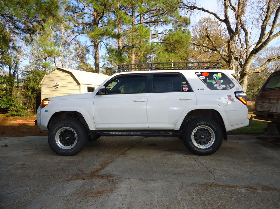

I'm at 2" with 265/70-17 AT's and perfectly happy with the look. YMMV
