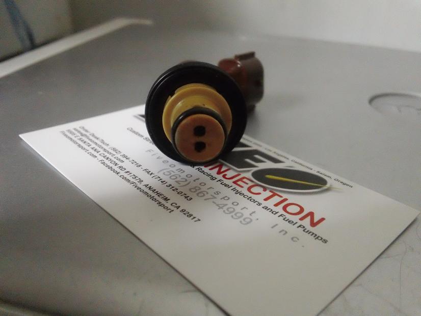

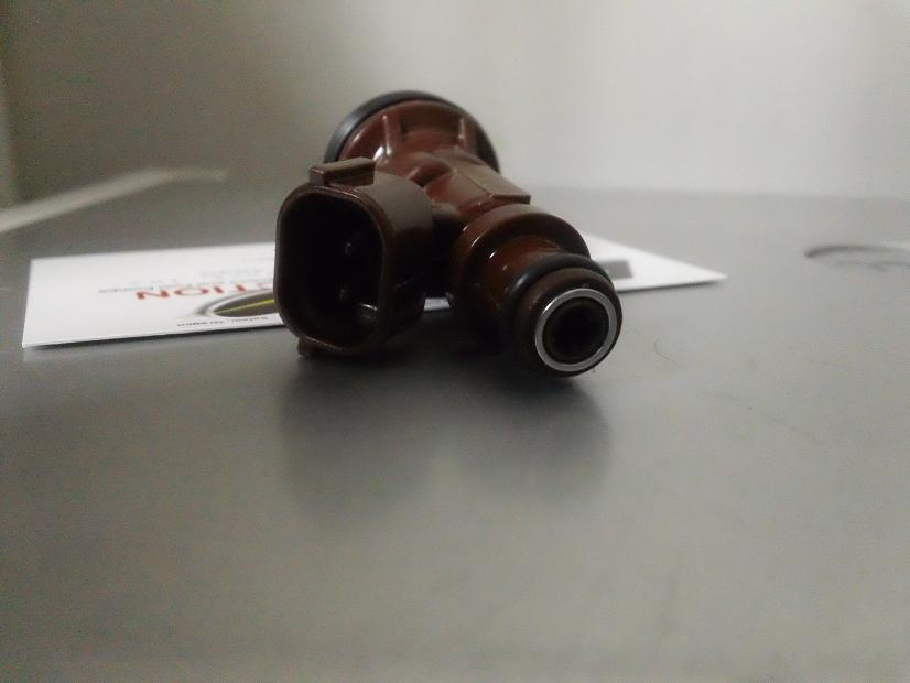

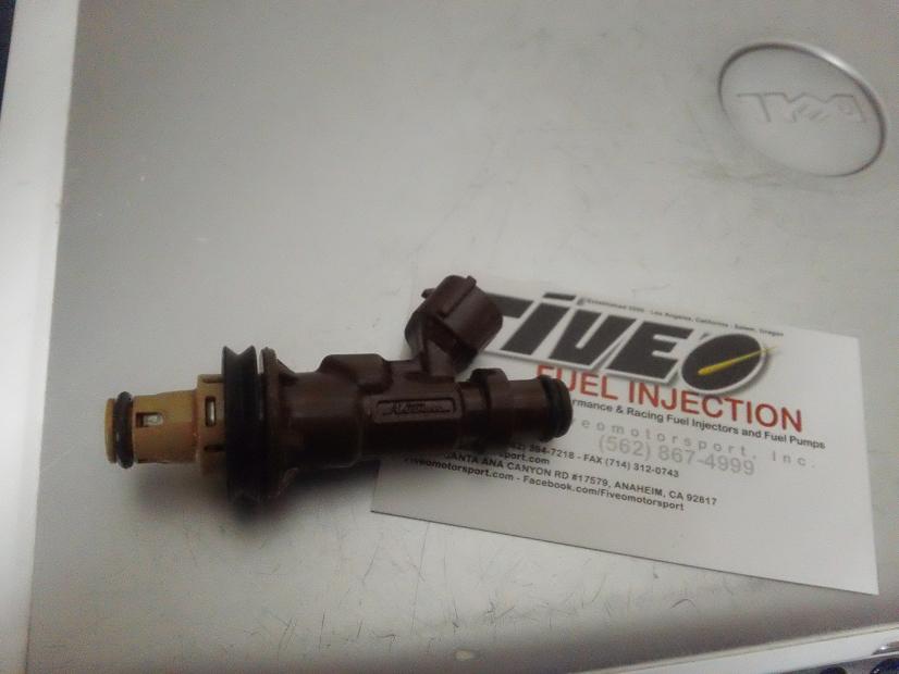

I just got my injector in the mail, i tested it with my OHM meter and its reading 13.8 OHM's. I am hoping to have my mechanic install this sometime next week

Good luck. Keep in mind though that your other injectors may not be far behind. Not trying to piss in your Cheerios but it's a real possibility which is why we were suggesting sending all of them to WitchHunter.
