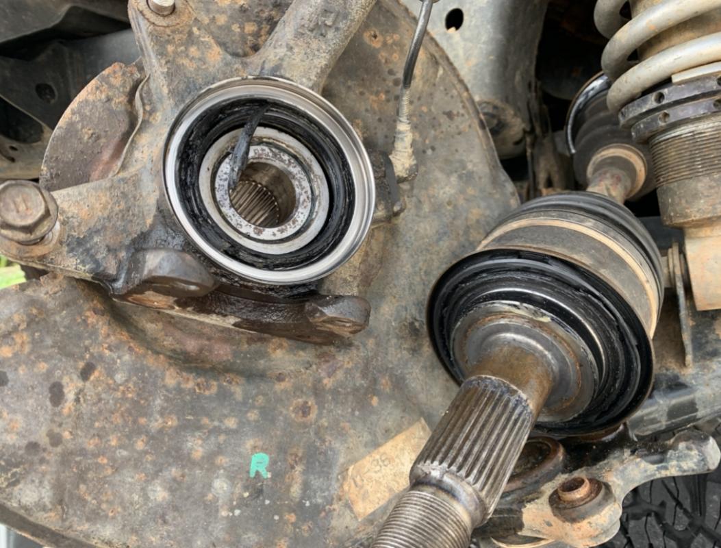

You’ll notice this is the right side, not the left side as seen in the OP, which means I get to take the other side apart and check it too.
I apparently didn’t fully seat the hub seal, so it ate up the hub seal AND the seal on the CV outer stub. I have a couple spare CVs, but gotta wait on new hub seals to come in. I am really hopeful that the hub-side seals are good....
