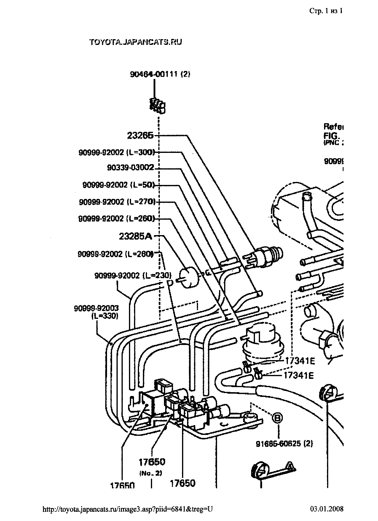

I am looking at a 1988 3VZ-E vacuum diagram and are those on the left side of the motor?
Anyways what i think from looking at diagram they may lead to "AS, FPU, EGR, VSV" whatever those are.
Also maybe a "AS Reed Valve" and maybe "EGR Valve" and a "check valve" that they may connect to also...

That looks like an engine ground wire that goes to any bolt that goes into metal on the engine. The other device that's tied into it looks like a large capacitor .47/250volt If anyone has a wiring diagram for this year T4R it will show it.
den said:
That is the same exact page I found last night. But in my book it is EC-19 I have the toyota service manual from the dealership.
As far the mystery ground I think I remember it going somewhere on the engine. So anyplace on the block is fine. Obiviously not on the heads as those are aluminum.
Hey den I couldn't get this link to work http://toyota.japancats.ru/details....reg=U&piid=6841
Yes that is the left side of the Intake Manifold Near the back if u look closely you can see a fuel line hookup and sorry I had to crop the pics to upload on photobucket. Specs on the car are 1990 T4R 4x4 SR5 V6 3VZ it's a 1994 motor but I switched to the 1990 intake to make it easier to pass smog.

Any idea where 17341E hoses come from... They are just laying on the ground... LOL when I figure those 2 hoses I'm done. The rest I can figure out based on that pic u gave me. Thanks Den You rock
Wow thanks again den! I contacted a fellow forum member and I am going over to his house to see how the rest of the hoses are hooked up. So I can stop wasting every1 else's time. :)
