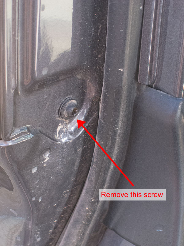

The key to completing this repair on my 2004 4Runner was noticing that the weather strip is held in place by a Torx screw on the inside of the door. The screw grips the weather strip at the rear of each front door, and at the front of each rear door.
When you have removed the Torx screw, it's easy to remove the weather strip from the door by pulling the weather strip upwards. There's no need to break the weather strip in any way in order to remove it. To install the new weather strip, you push downwards on it until it clicks into place, then install the screw.
The Torx driver you will need to remove/replace the screw is a Torx T20.

Ditto Coyote
Yes it is that easy as Backlitcoyote says. Unscrew the torx and stripping pulls right out. I had to lift the edge (torx screw side) a bit and put a flat head screw driver in the molding to pop it out of the groove. Then it easily pulls right out.
