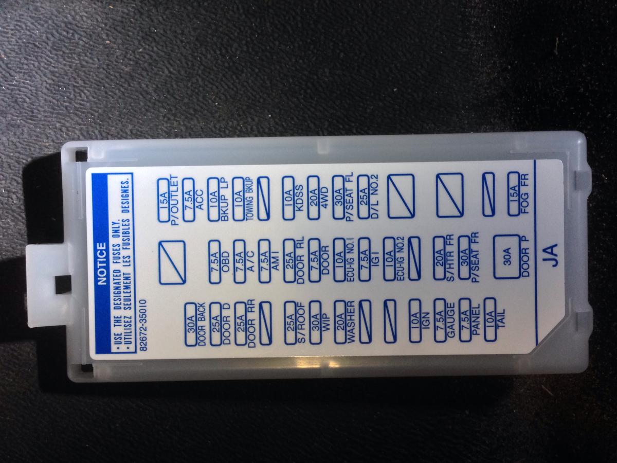

I was playing in the interior (by eBrake ) fuse box, and I was playing in the ACC spot.
Cheers. I'll go check right now....
This is what I see....
I don't see one marked #13 or EFI

I pulled the 10A IGN and the 7.5 ACC, but they are both back in as stock...
The only other thing I did was test with my voltmeter.
Check any and all fuses you pulled with an ohm meter to make sure they are good.

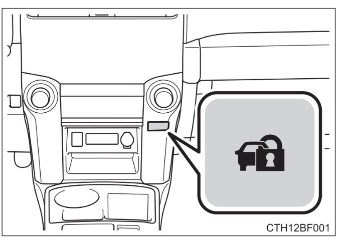

Does the security light stop blinking when you put the key in the ignition?
Vehicles without a smart key system
The indicator light flashes after the key has been removed from the engine switch to indicate that the system is operating.
The indicator light stops flashing after the registered key has been inserted into the engine switch to indicate that the system has been canceled.
Maybe try your other key

It flashes when I open the door
When the key is inserted, it stops flashing and turns off
I take the key out, and the flashing returns
