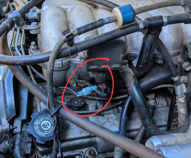

First up is this guy, spliced into the diagnostic plug harness.

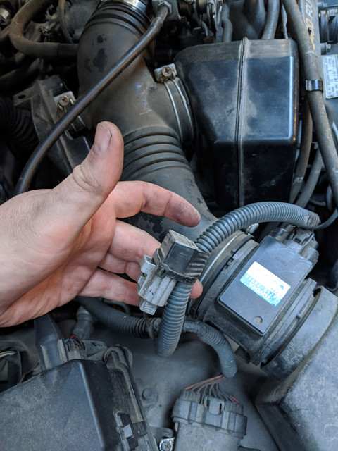

Second is this thingy zip-tied to the MAF harness

Alright, so I chased those wires and it led me to a janky alarm install. So I pulled all of that out.
