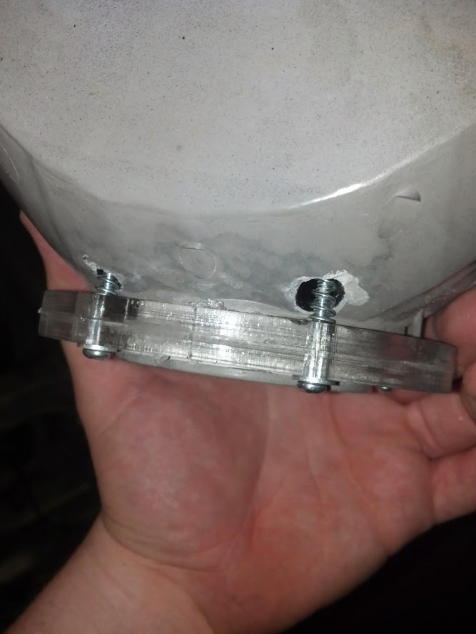

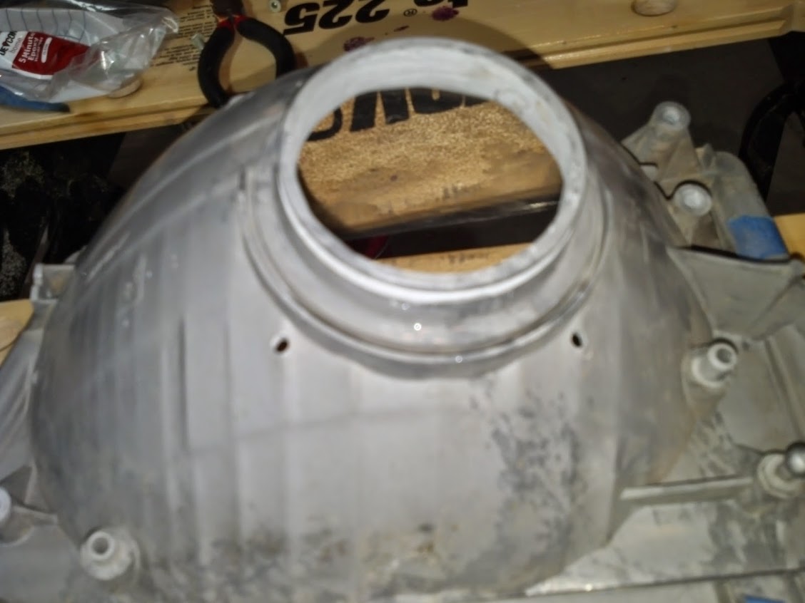

I got around to redoing my projectors a few weeks ago, I was trying to figure out the best way to align the fx-r's to the bore on the back of the lamp. At heatsync labs, a local hackerspace, I used the laser cutter to cut some plastic rings that I could use to get a really good alignment for the screws. The rings worked perfectly, other than one projector was a little twisted, but Its pretty easy to just turn it and fix it. whats nice is I made the rings have the same hole pattern as the projectors mounting holes, which makes it super easy to figure out where to drill the holes. the other thing is as long as you have the dimensions and spacing for the mounting holes this could work for any projector retrofit on the 4runner. also if you look at the glass lens of the headlight there is a little circle that lines up with the axis that the bulb should be going through, your projector lens should be perfectly centered on the mark. if you want the file i have it somewhere on my computer, you could make the rings by printing the pattern out on paper then drilling the holes manually, you could cnc, 3d print , water jet, or laser them as well if you have access to one of those.
