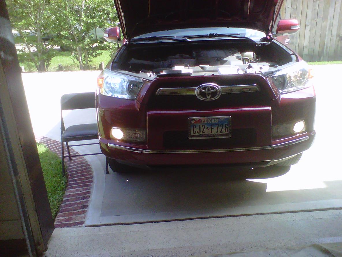

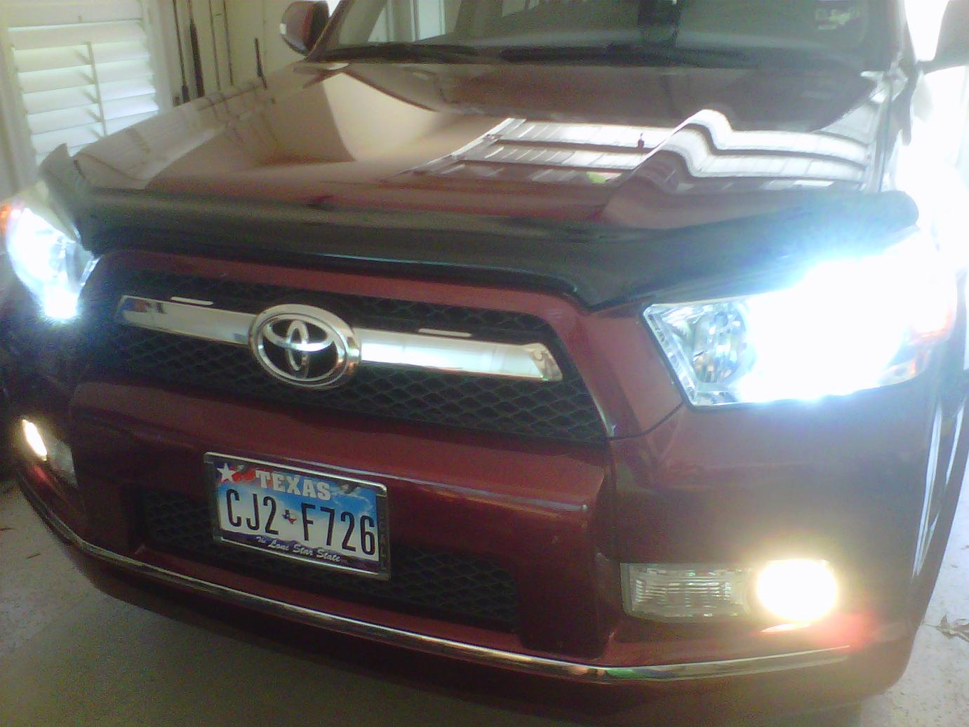

After some research, I installed some HID bulbs on the 4Runner this weekend. I dove into other forums and they suggested HIDmasters (HIDmasters) had the best bang for the buck. Apparently, it's the exact same product as DDM's but much cheaper. I bought the basic package (H11's, 6000K with full sized ballasts). Simple plug and play. The HID harness snaps into the OEM harness. I paid $60. The light is bluer than I would like and the pattern seems more scattered than the regular bulbs but for $60 I am pretty happy.

I'm sure everyone else on the road will be just as happy when you blind them.
Yep. Illegal and irresponsible. Especially in a vehicle where the lights are as high as they are in the 4Runner.
Either pony up for the real thing (projectors) or stay with normal bulbs.
LMAO not my cup of tea but no different that everyone slapping ultra white sylvania's in there if you ask me
It is actually very different from "slapping" Sylvanias in there. Halogen bulbs will still maintain the appropriate cut-off.
Try again.
all I can say is, "You get what you pay for". If I were a betting man, I would throw a $20 on a bet that says that you probably decreased your "effective lighting" with those lights. First off... just based on the pic, those look like probably 6000K (***edit*** just read the OP, they are 6000k) temp lights... Anything past about 4000-4300 does nothing but decrease the effectiveness of the light. Second, those cheap HID kits have horrible beam patterns, the glare thrown off to other drivers and on coming traffic is probably close to blinding.
Might wanna re-think this one.
