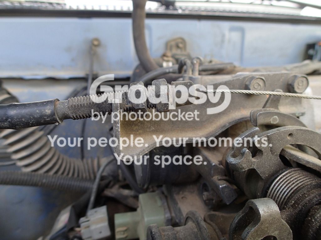

Something like this?:
Using a cable routed through the same bracket as the cruise control (96) to where there is a fin the cable could be hooked to. Would keep it from getting tangled with the throttle cable...hmmmm....
(pic from another project- cruise control bracket, cable are loose, but it shows the bits I'm referring to)
P5159550_zpskgcrznbs.jpg~original
I think I still like the idea of messing with the coolant temp sensor and a switch, but this certainly bears some looking into as well.
Thinking on this cable idea further....hardest thing might be to keep the cable such as the cruise control cable from unseating from the actuator when you override with the throttle cable...would have to look into how much slack happens when you raise the rpm for your high idle.
Then again, what happens to the cruise cable when you hit the throttle anyway? It doesn't pop out then...
Some out-loud thinking...needs some actual on-hands tinkering for answers...
Edit:
Went and looked. The middle actuator (sorry, dunno the actual term for parts that move the butterfly) works separate from the cruise and throttle cables (96) so the new throttle wire could theoretically be used with it, using the cruise control cable bracket as a base, or fabbing a different bracket. It has to be pulled overhand from the right side. If you use the provided holes (actually in the pic, the actuator in front of the cruise actuator) you wouldn't be able to pull it much, but it shouldn't need much anyway. It appears to be a feasible idea [MENTION=102597]IBallEngineer[/MENTION]. May have to give that one some actual ear steam.
