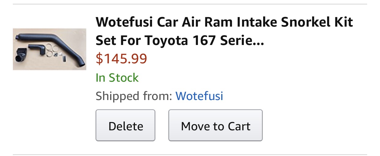

Is this the brand everyone is getting?....
This is on Amazon of course...

Yeah. Looks like the one I ordered. It will be nerve racking to try and make everything fit and line up.
