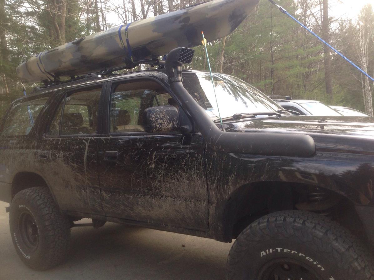

Thought I'd give some feedback following my install which was the BIGGEST PITA.
First... I'm fairly mechanically inclined and this project took me WAY longer than I expected. I like to do most of my repairs myself, but make sure you give yourself plenty of time. I ran out of daylight and then it started raining on me :rain:.
• Do yourself a favor and buy some of the plugs they mentioned earlier for the mud shield. You'll need them.
• The 3 5/8 saw hole makes for a really tight fit. You'll likely need to clean the hole out a bit with a regular drill bit for a little more clearance.
• don't be shy about using a little bigger drill bit for the bolt holes. The washers from my amazon kit were huge and the little bigger bolt holes allowed me to maneuver the snorkel easier (and without damage to the threads of the bolts).
• I used a can of spray paint to paint the holes I had made... hopefully to provide a little rust protection. Doesn't have to be pretty... just have a rag handy to snag any drips... it'll all get covered by the snorkel anyways so no need to be perfect.
• For the snorkel attachment on the A-pillar... don't drill your holes for the A-pillar until the snorkel has been fully tightened down to the body of the vehicle. My holes came out about 1/8 of an inch off and the snorkel had to flex a bit to get it mounted. (And definitely use the rivets. For those that haven't used a riveter, keep pumping the riveter until the stem fully snaps off. This is how you know the rivets have secured fully to the sheet metal and snorkel bracket).
• I tried to install the rubber elbow onto the snorkel before feeding it through the fender and that didn't work for me. I had two hangers inside it which made it difficult for it to flex which resulted in having to install the rubber elbow inside the fender like everyone else.
• This was a helpful tip mentioned earlier: **use a long screw driver to pry the end of the snorkel away form the fender so that its easier to slide on the rubber tube.**
• For the rubber piece to the air box... use a little grease or motor oil to lube the end of the rubber. Vice grips on the bottom, a small screw driver, and a boat load of patience finally resulted in it seating properly. An extra set of hands would've helped tremendously, but unfortunately I didn't have that option (or a heat gun for that matter... tried the wife's blow dryer but not sure it helped much).
• Cheapest place to buy the tools was harbor freight for the mandrel ($10), Amazon ($10) for the hole saw and Home Depot for the Riveter ($10)
Thanks to everyone that's contributed to this thread! :beer:

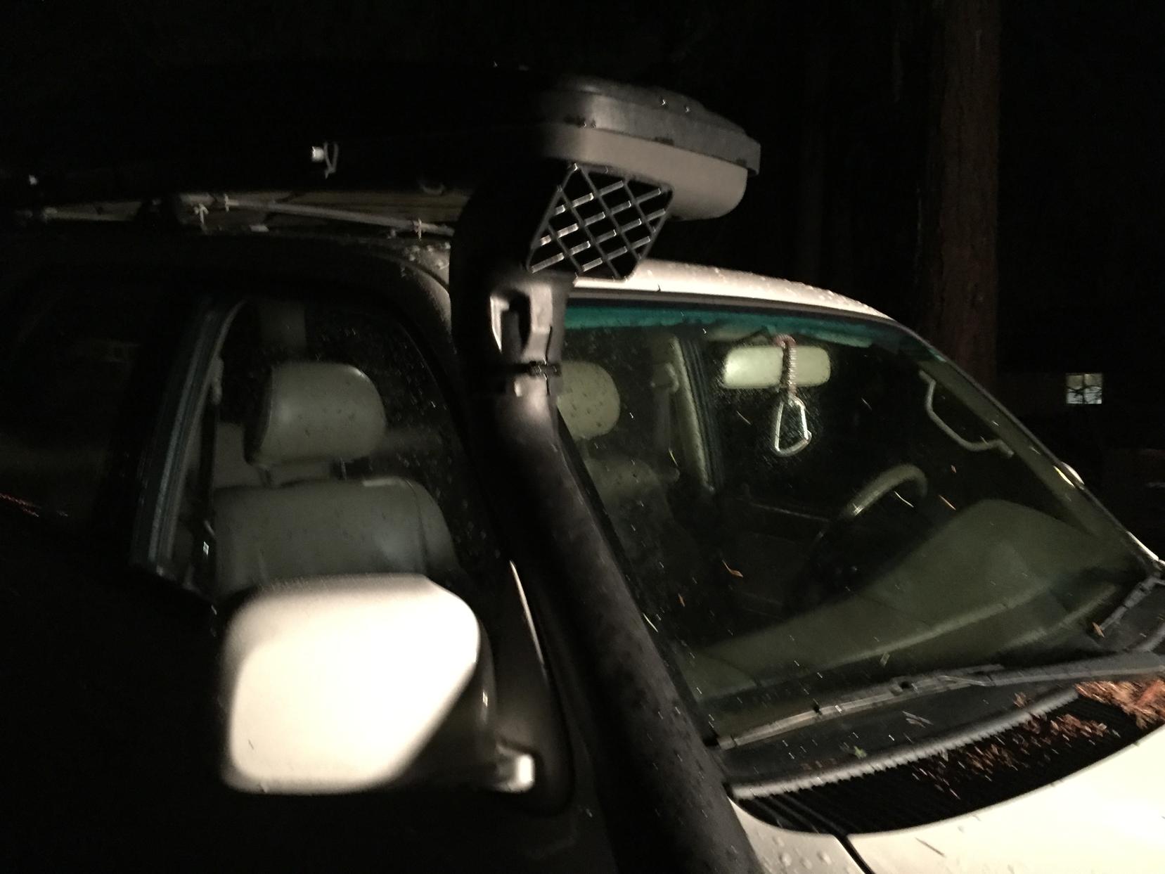

Success! Got it all setup, looks great too. The biggest PITA was getting the L tube onto the snorkel itself, pushing the snorkel from the fender definitely helped it on there. I'll look at the the L tube again in a few weeks to make sure its on there tight still.

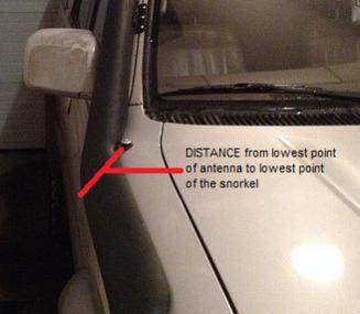

I am interested in doing this mod. However, I installed Side Marker lights on the fender. Can someone please measure the distance from the lowest part of the antenna mount to the lowest part of the snorkel. As attached.
I do not have the paper template and would like to know if the snorkel will clear the side marker lights.
The pic is rendered from Zig553 post. Hope you do not mind me using as reference.

Hi, no problem about using my pic. Did you need a template? I still have it somewhere, I could probably just mail you mine.
Is there any gap between fender and snorkel?
There is a tiny gap in the crease of the body line, probably could be fixed with a little adjusting. I have since broke a lbj which collapsed the truck onto that fender as well as got friendly with trees so it's not the prettiest thing. I'll snag a pic if I can today

Sorry for the delay, I can fit about a quarter of my index nail between the body and snorkel
