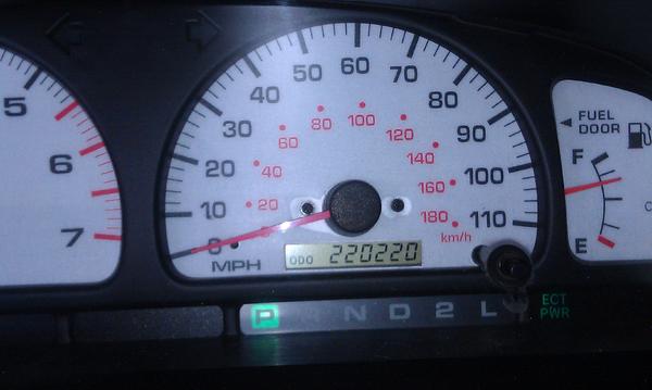

I replaced the gauge faces on my 99 with white Tacoma faces about 15yrs ago from eBay. Still working fine. came with it's own dimmer and ability to light up green or blue. I remember you could get all kind of different looking faces and pointers. they just install where the old face was by removing the two screws.
search for Tacoma white gauge face
