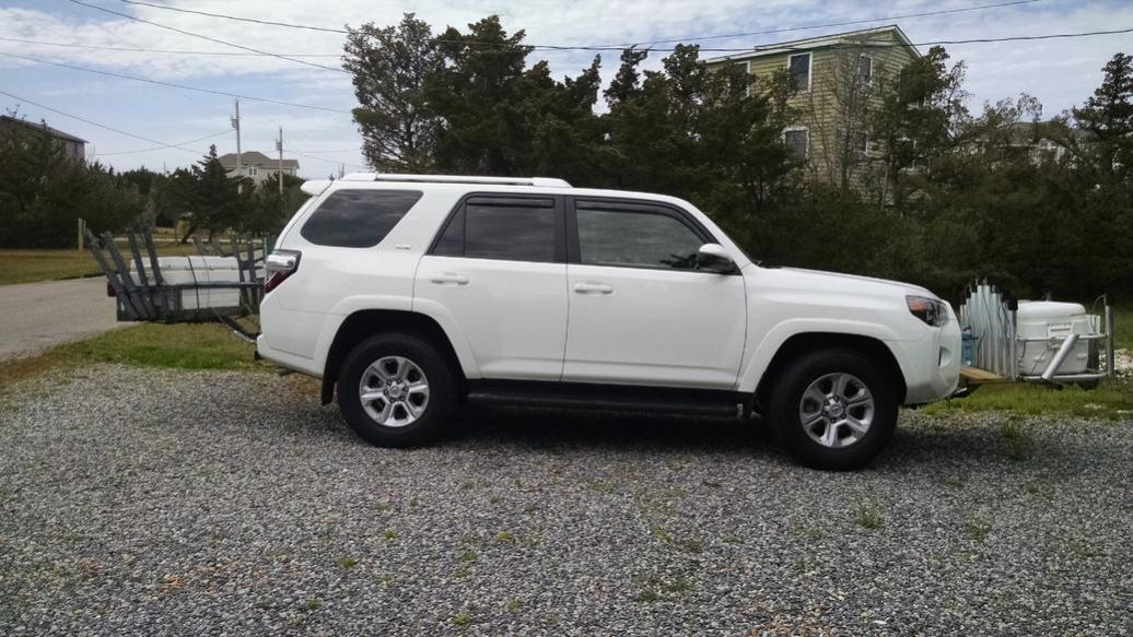

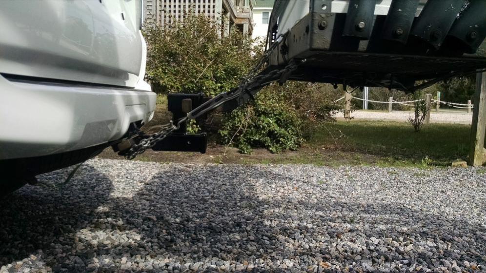

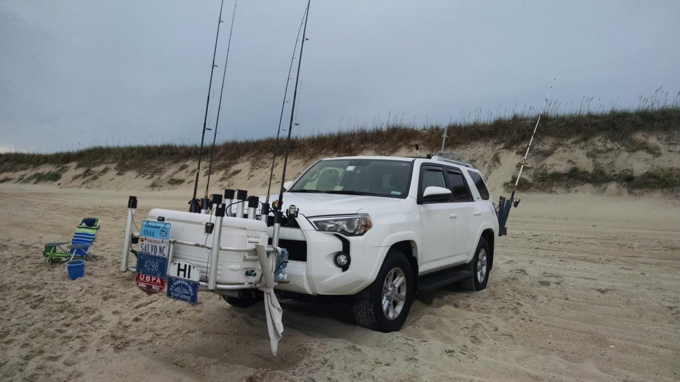

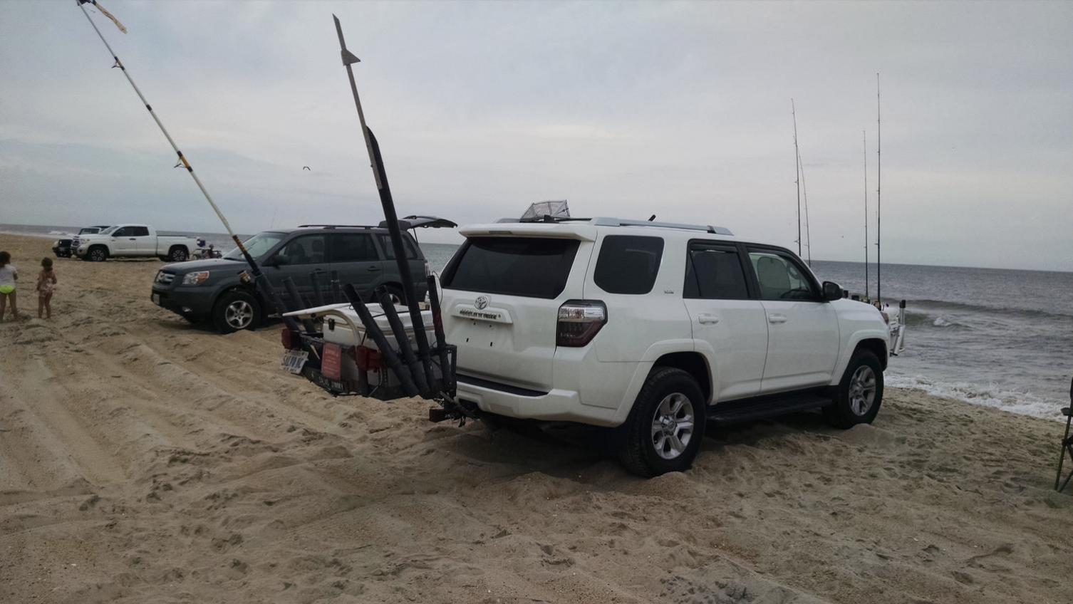

Here ya go. Hitch Haul with their Z-bar to improve departure angle plus double hitch receiver to give further lift and clearance so lift back opens and clears cooler and corrugated angle iron to form basket and PVC pole holders

Thanks Salvo.
I see the extension you are running. That may be the ticket.
I dont need better angles and I actually dont want to run the front one because of my aux lights.
