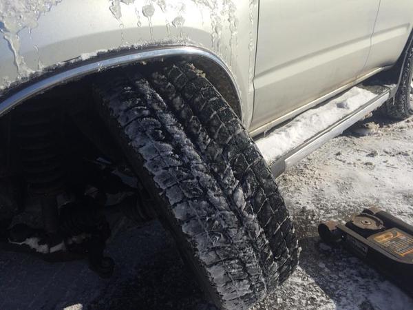

Holy crap, more LBJ failures!
I will have to admit, I'm a Facebook user.
I'm a member of the group 3rd Gen 4runner Mafia, and just in the last 8 hours, I've seen 2 posts of LBJ failures. In the last 3-4 months I've seen a dozen. As 4runner enthusiasts we are all well aware of the few shortcomings of our trucks but everyone please Everyone, if you have a 3rd gen, and you've never changed your LBJ's, please do so. If you have a jack and know how to use a ratchet, pliers and a hammer, you can do it yourself. Use OEM, yes, they are a little more money but worth it! Using anything else is false economy!! For a few hundred, you eliminate the possibility of DYING, and at best, saving having to replace racks, UCA's, UBJs, CV's, tires and yes, LBJ's!!!!
