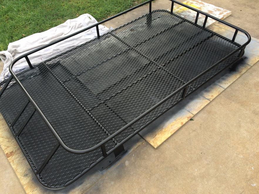

Started by building the frame out of Uni-Strut. (Don't mind the dog)
Getting painted.
Different angle.
I really like the low profile and simplicity. Haven't seen the uni - strut before. How's the strength?
I have a design and hopefully it gets built soon lol but I am going for low profile and full length as well.
The uni-strut is very strong. I've had the rack loaded with probably 150 lbs of gear, plus myself standing on it to strap everything down. No issues. The cross members are 3/4" square tube and are notched into the uni-strut and welded. I chose not to run the expanded metal mesh the full length because the front of the rack sits on two 2.5" diameter rubber feet directly on the roof. There is no roof deformity, and I used stainless hardware throughout. I will say though, the uni-strut was a complete pain in the neck to spray inside because of the "C" channel design. I plan on taking it off, sandblasting, and having it powder coated in the spring.

Finished that roof rack
