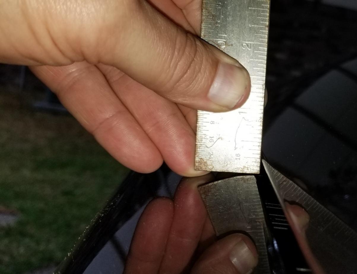

Wonder if I just got a dud? How much gap did you have between the hood and grill before?
I'm lucky to have 3/16".

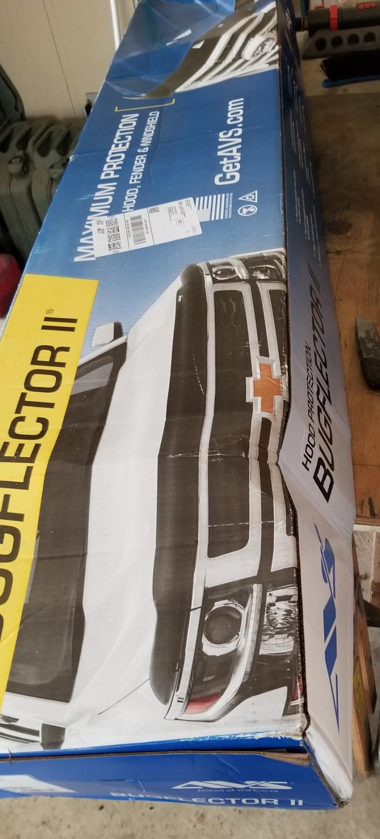

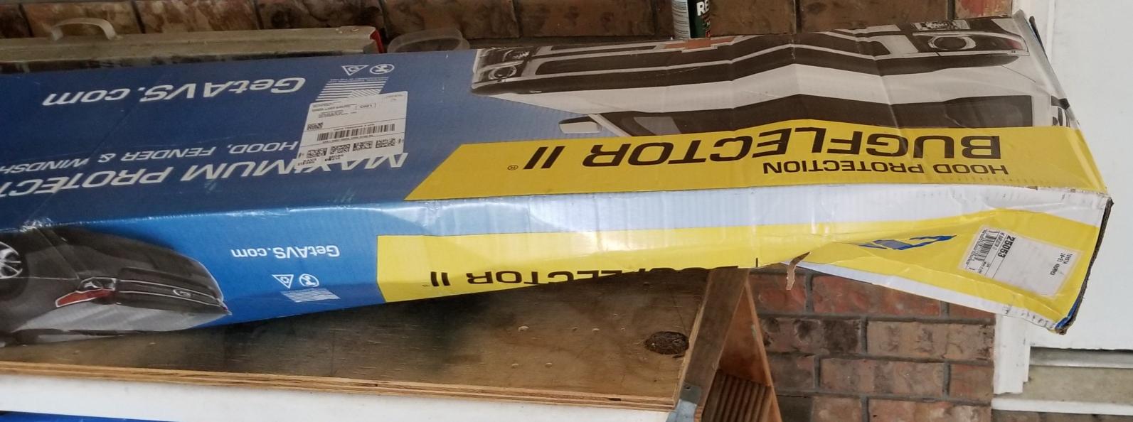

Let's start at the beginning. Packaging arrived much like one would expect from the "no ducks given" service sector.

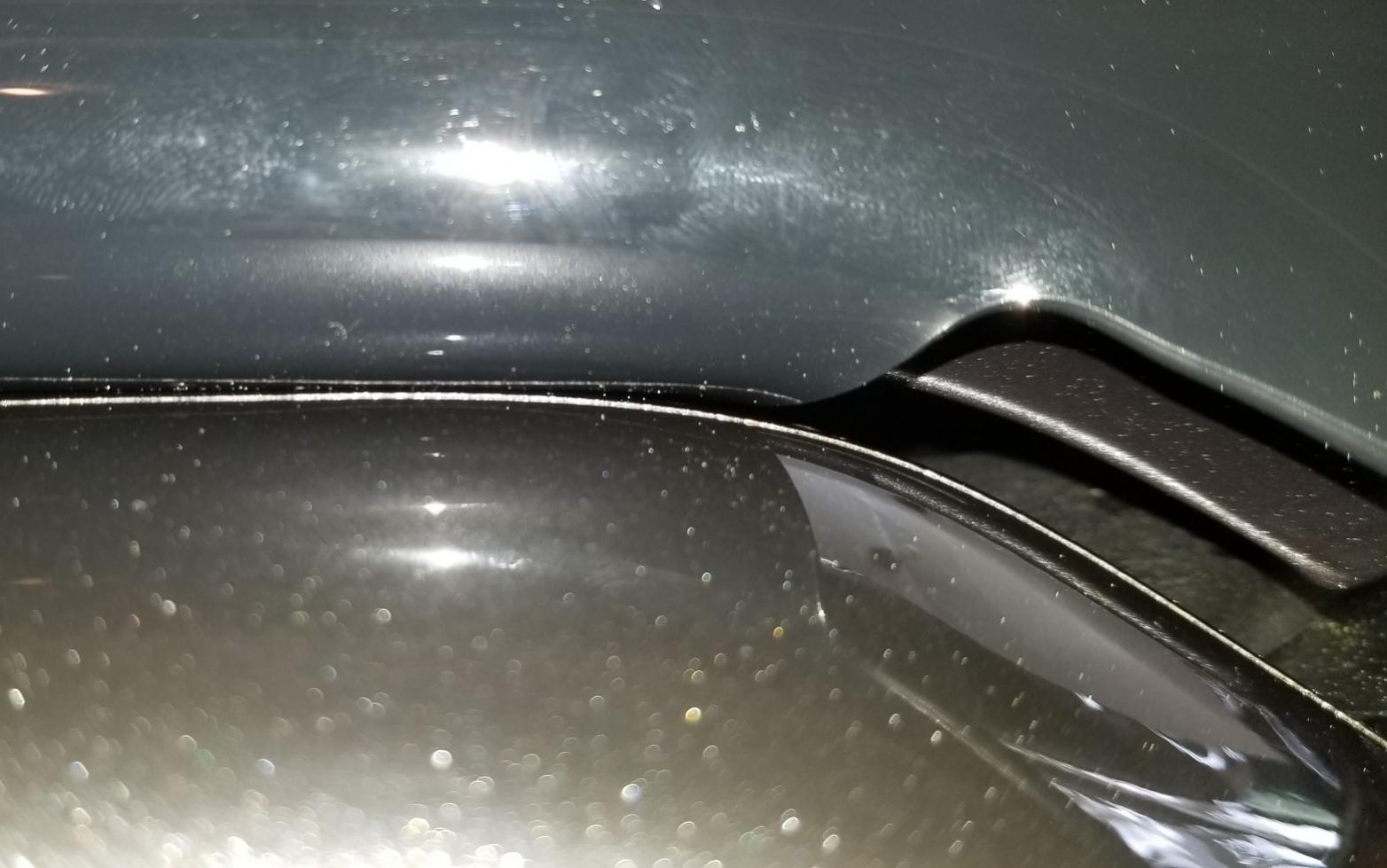

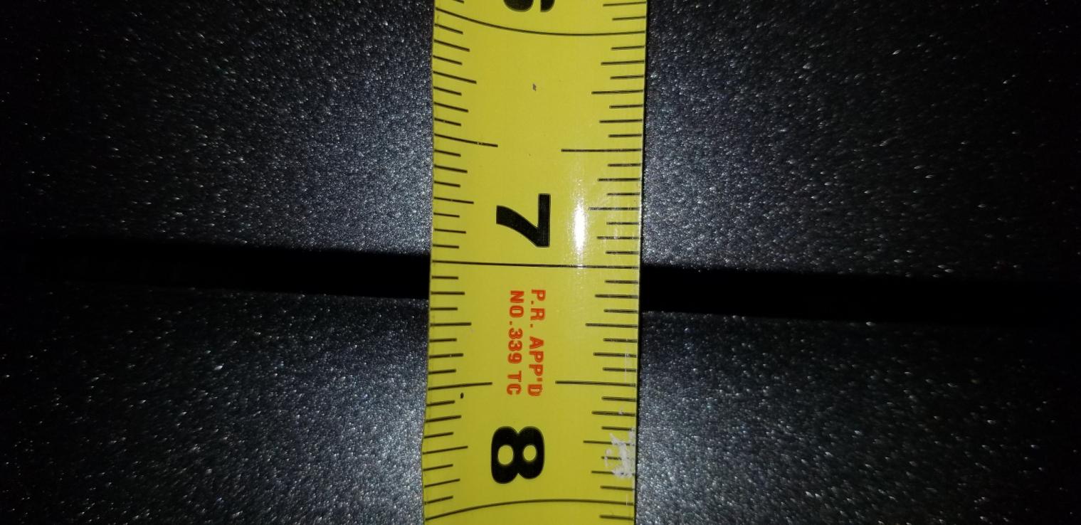

Hood spacing was 3/16" ( battery died in the calipers, excuse the primitive measuring devices).

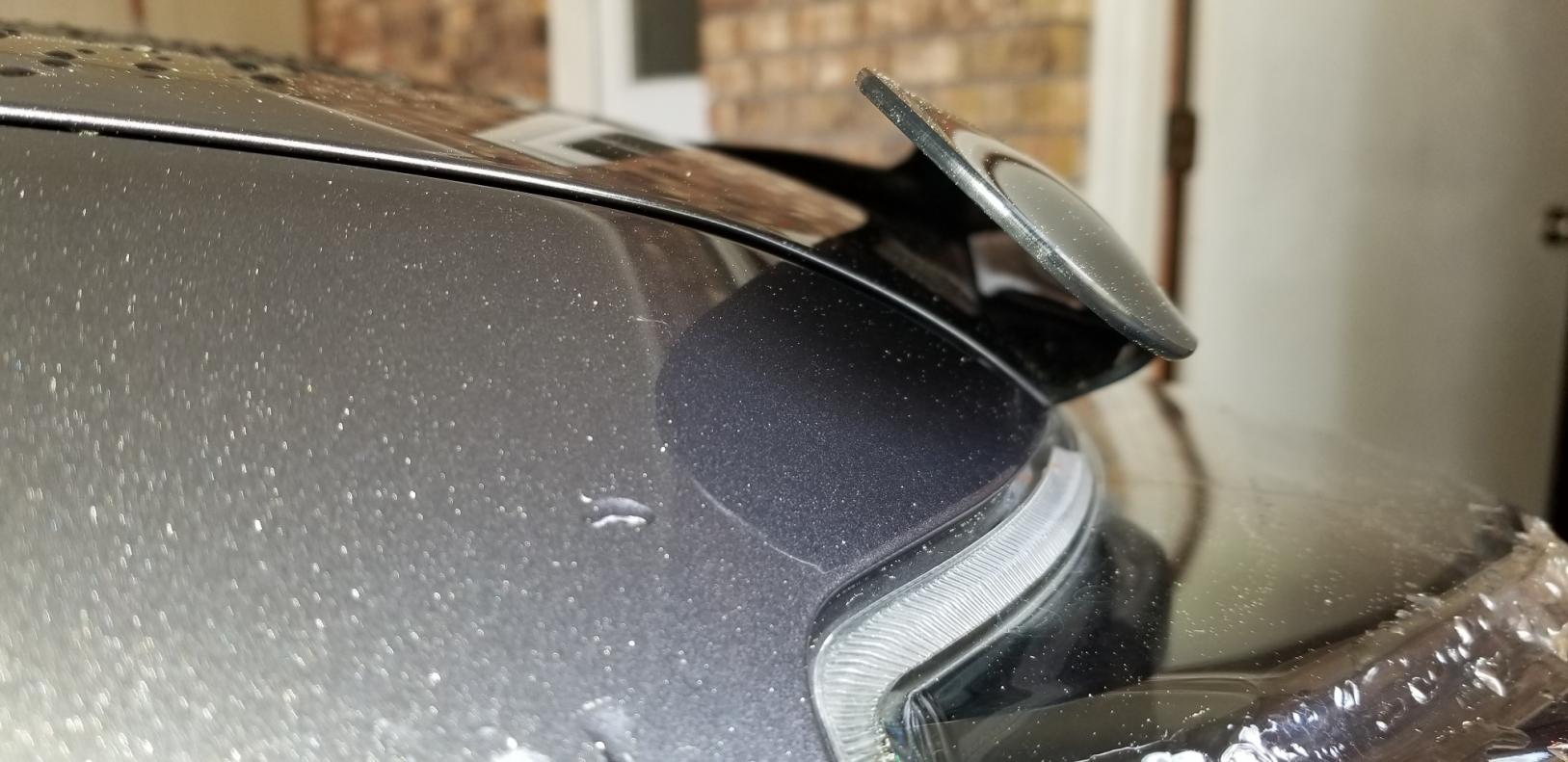

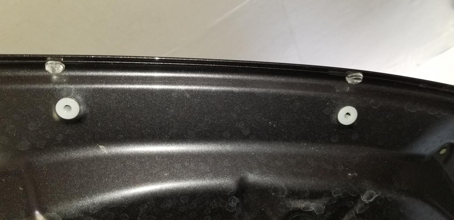

Install is Barney enough, noticed contact with the paint at the bottom of the leading edge and added the supplied bumpers to the under side of the hood (just the two over the headlights. Center section doesn't have the clearance).
