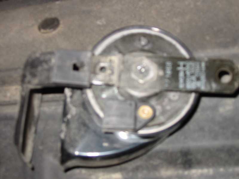

The before pic:

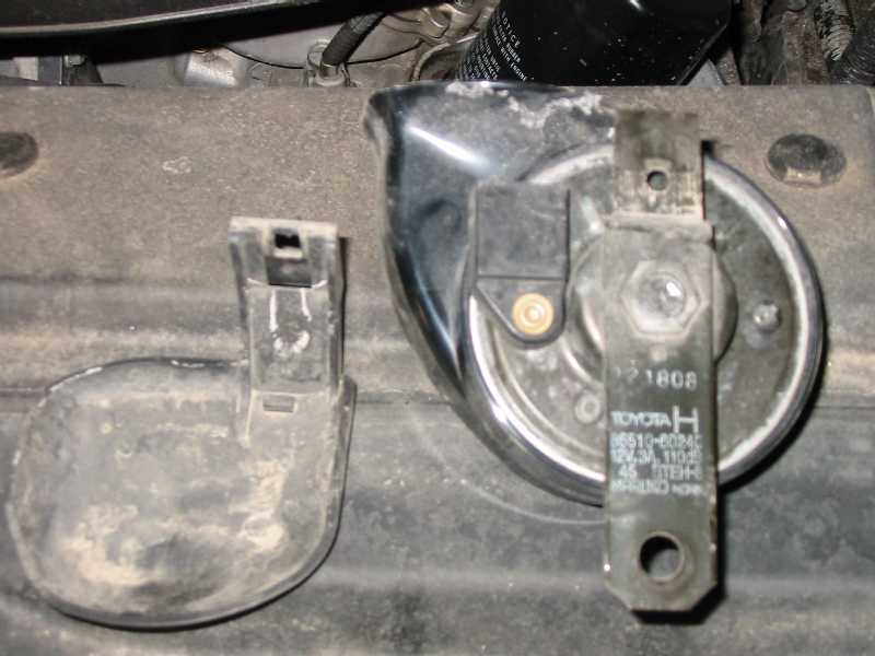

I then unbolted one horn and guess what? You don't have to break anything. They slide on and hold with a tab. Pull back the tab to remove. Reinstall at a later date if you want (why, I don't know?)
Partially removed:

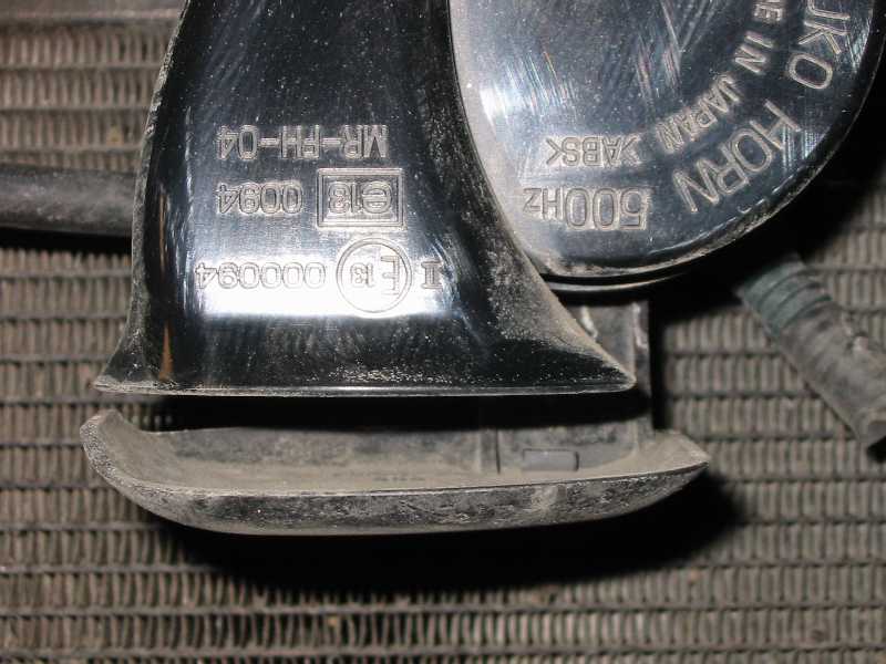

Now fully removed. Yes, they are louder without the shield (test it in a garage before and after or ask grandma for her opinion.) As was suggested this could be a regulation thing for sound level. If it wasn't required in some other jurisdiction (ie. Europe) then Toyota could just leave it off.

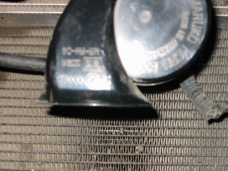

Now I could really be called a post-hog if I gave an after installed pic.
TranceKrayz, do you really need one?
Oh, what the heck...
Went outside and spent all of about 15 minutes doing the Horn mod. Horns sounded the same before and after. I decided to leave the "splash guards" on there. :D
