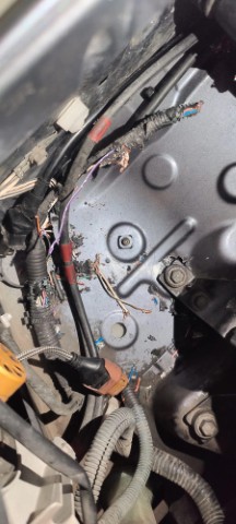

Some squirrel(s) chewed through multiple harnesses on the passenger side, including ABS, blinker, windshield wiper, windshield fluid, etc.
Is this repairable/ worth the effort?

Can't really zoom in too well on the pic but it looks like it's easy to access which is the biggest thing in my opinion. If you don't know how to solder, pick up a kit and watch some videos on it. Simple enough to do. Use seal-able heatshrink to cover up the splices. Cheap fix if you do it yourself.

This is the harness under the air box feeding the lights, indicators, VSC, etc
My fear is that the whole harness needs to be replaced which would be a lot of work.
If it is just soldering all cable together, that would not be too bad, just need a bunch of right cables to extend and can hopefully identify the right colors...
Stefan
If you have time ,and its not your daily driver, its possible to repair with soldering similar wire into place as splices. I did this to a shop Ram van V8 3500 years ago.
First you need to get comfortable positioned if repair in place is your goal. I fabricated a wide board with padding to lay upon. Most likely wire positions and insulation color will allow matching ends to splice.

Indeed, it is my wife's daily driver and I'm traveling out of town, there was time issue. I have a soldering iron, but not the wires in the right size....
With that, I was glad to find a good shop that completely fixed it yesterday for $400.

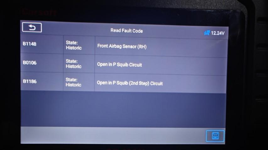

airbag sensor
I wonder if anybody knows where exactly the airbag sensor is or which color the cable is that is is connecting the sensor.
I thought I had it all sorted out, but it seems that there might be more cables damaged that are not obvious to see.
Thanks for your help!

Typically airbag wiring outer sheaths/looms that bundles the airbag wiring together are yellow and all the connectors are yellow, the wiring inside the sheaths/looms can be different colors.
That being said look for yellow connectors on sensors to try and track down the airbag sensor.
Here's a link to search results for the front right airbag sensor location that may help.
Google Search
There are 2 airbag sensors and they're towards the very very front of the car, on each side. Look for 2 identical sensors with the hood open. Can't miss them.
Ok, the weird thing now is that the error code does not come up again, but the VSC and trac lights are still on.
At least I can't read any errors with my code reader CR MAX.
Maybe I need some more specific Toyota reader....
If you go look up the zero-point calibration procedures you can find the method to pull the codes without a reader. You need to jumper 2 OBD pins and then follow the instructions and it will flash out the code.
I had the exact same issues with mice eating my wiring, and the error code led me to the correct wire where I did in fact locate mouse damage that was hard to notice.
This is great, thank you! I did the zero-point calibration before even used the code reader. I wasn't aware it can actually throw some codes.
