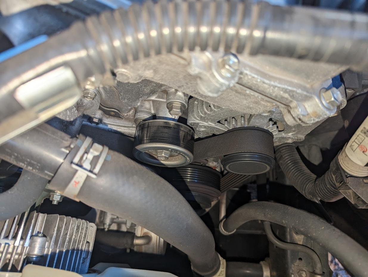

At my 65k maintenance for my 2016 SR5, they recommended drive belt as routine maintenance, since the schedule calls for 60k or 5 years. I've heard some people say they've gone 100k on theirs. How do I know it needs to actually be replaced? It looks okay to me and I don't see any signs of wear, but could there be stress on it that isn't visible that causes it to eventually break?

If it's not making noise or doesn't show any cracks on the inside of the belt, I'd keep rolling with it. It should easily go to 100k, then you might think about replacing it as a preventative measure.

Just changed mine on '17 with about 97K miles. Planned for early preventative maintenance at 100K. Belt change took maybe 20 minutes. Checked idler and tensioner pulleys and they were all spinning fine. Nothing squeaking.
Old belt looked fine - no cracking on ribs. 60K sounds way too early.
Slip your camera under that top idler pulley where the belt is flexed backwards and take a picture. If you don't see cracks, you ought to be good. They're simple to change. Only cost about 50 bucks. Make sure when you change them that you take the time to exercise the pulley tensioner otherwise you may have problems. Sometimes they stick after not moving for some time.

The accessory belt seldom breaks or has "wear". The usually problem is the belt will become glazed due to heat, then it will squeal as it slips over the pulleys. That is the time to replace it.
You can tell a belt is glazed because it will be shiny and the ribs will be hard and possibly cracked. Yours does not look like that.
