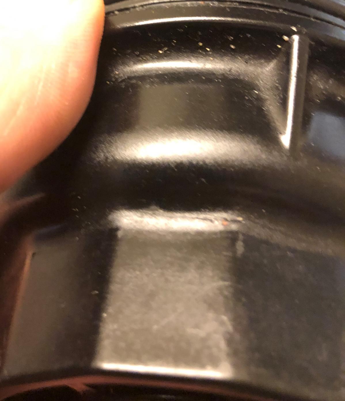

I discovered Toyota Dealer overtightened plastic housing when I began doing my own oil changes and had to use a cheater pipe on a 1/2-inch flex handle breaker bar to remove it. Plastic housing cracked and I replaced it with a metal one.

Swapped mine out on the first oil change. Cracked one of the ears as whoever did it prior over tightened it. No issues since. No issues with our Lexus that has metal either.

The only issues I have seen with the plastic housing is user error. Many have gone with the metal housing without issues and part of the process of going to the metal housing is swapping the stand pipe.
Yeah, I did the aluminum housing swap.
