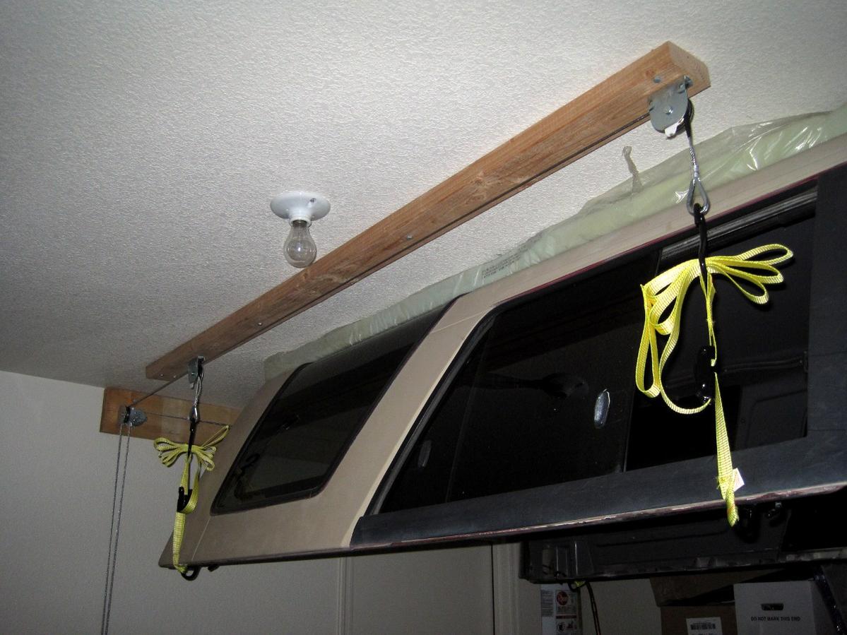

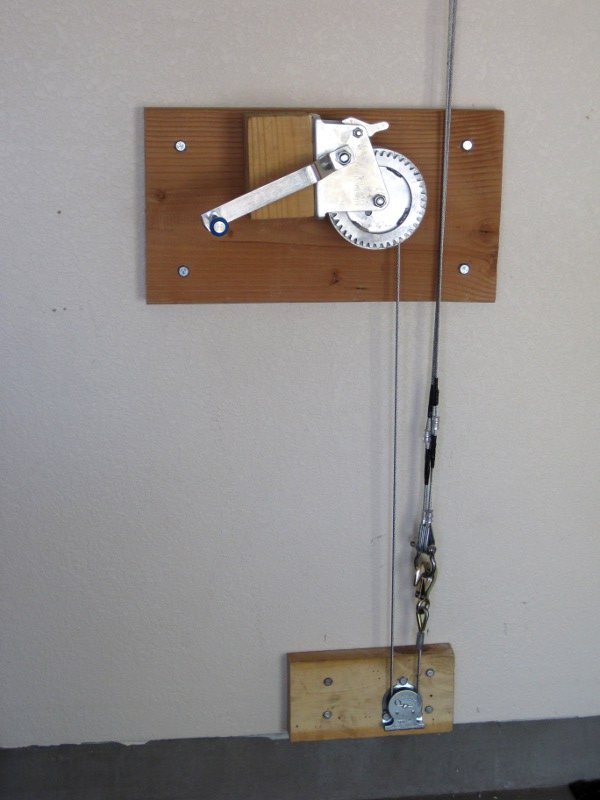

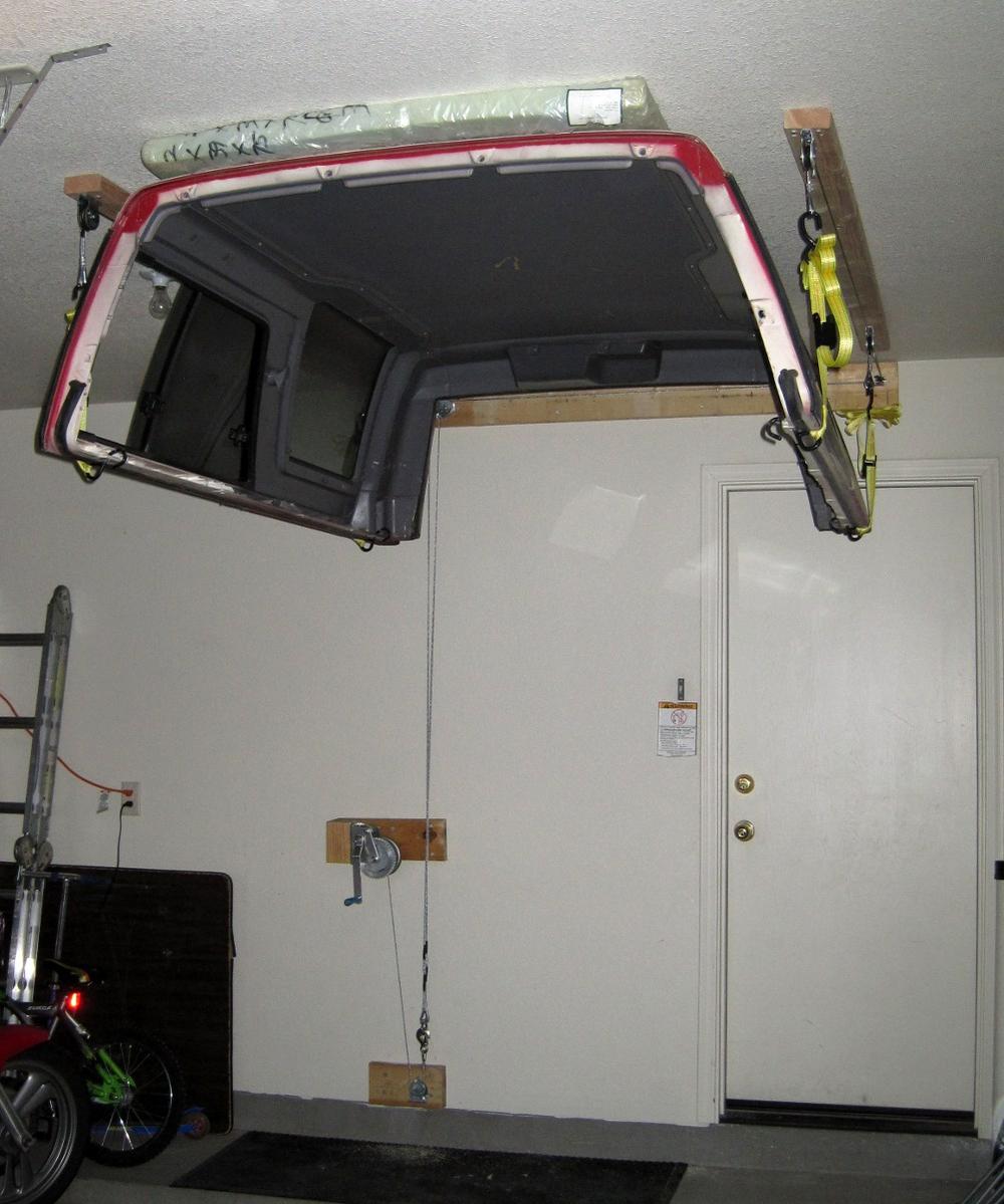

I've been intending to post photos of my latest hoist project. I'll try to share a few here:
Dude that is incredible! You mind elaborating on the parts you used to construct that? I.E. prices, part numbers, availability of the cables, winch, and pulleys that you used?

I'll try to start a new thread with the info on it. I'll have to figure a way to upload the PDF drawing/plans I used...the file is too large right now.

Rescanned my drawing and was able to upload:
http://www.toyota-4runner.org/classic-t4rs/100278-hoist-1st-gen-topper.html#post889965

Make sure you check out my first reply to the thread, as I added a scan of my Lowes receipt.
