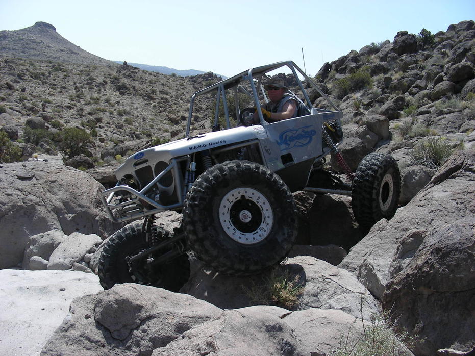

This one was over 4000 and that was with dual cases, tube winch bumper {Warn 9500 with syn rope}, and an all steel flatbed. If I had known then what I know now, I could have knocked 300 or more lbs off it in the build.

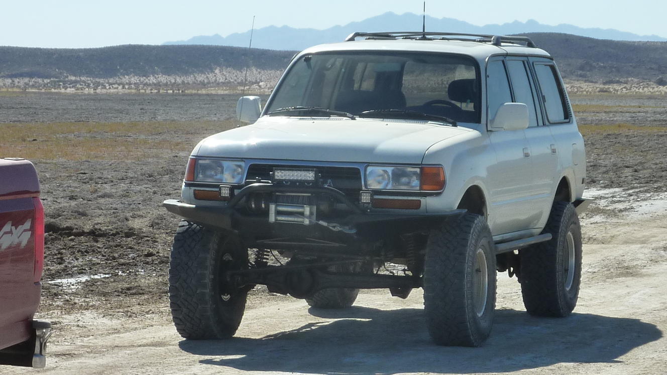

And this one was near 6000lbs. Plate bumpers, tube rock sliders, 12k winch with steel rope, 3-link front with coilovers, 35's, etc.. There wasn't much room to shave weight on the FZJ80, what it really needed was an LS1.

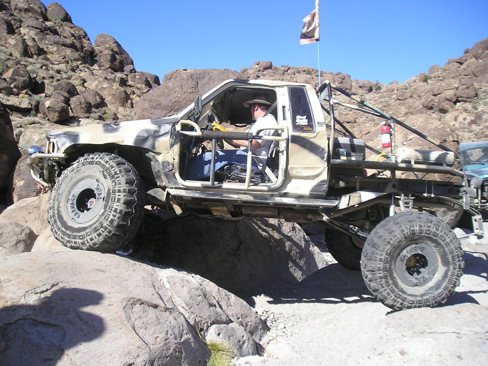

I ran Toy mini truck axles on the camo'd '85, Bobby's 30sp up front, and the Poly Performance tapered axles out back, and even with 38's I had very little breakage in 10 years with that truck. True I broke near one of every thing, lock-rite, locking hub, front R&P, rear R&P, I didn't keep breaking the same thing over and over, so it was acceptable damage in my opion for the types of trails we were running. Hammers, Rubicon, Area 52 Moab, not the easy stuff. One tons are great for strength, but the ground clearance you loose sucks. A fabricated 35sp, HP 9" is the way to go IMO, and if I ever build another rockcrawler that's what I'll be doing.

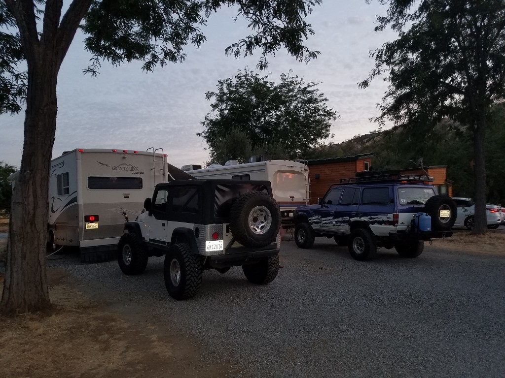

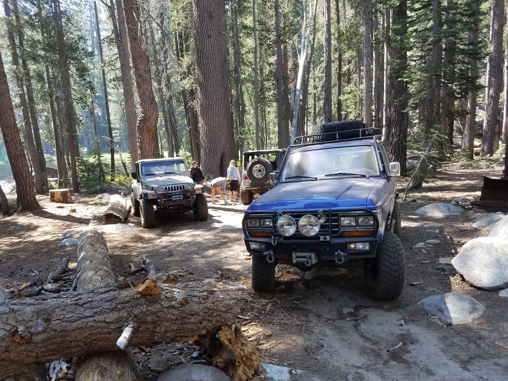

Almost 7000 baby! 1/4 steel plate bumpers, 3/16 tire carrier, lots of .120 wall tubing on the roof rack. FZJ80 axles with one ton steering. Oh yeah, 4l60 and a 5.3. 2 spare tires, lots of recovery gear and 6 gallons of water. I usually carry everyone else's extra sh%^&t too. I did save a few pounds using a 12K Hydraulic winch, but I still have steel cable. That winch is 22 years old! Rear axle alone displaces 3600#.
I suppose that is why I broke the left front leaf within minutes of taking this picture!
The motor home wants it on a diet too!

You might know this one.
