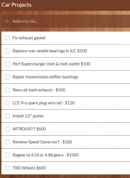

If it helps with ideas, here's my "To-do list" for items and things I want to do with my 4Runner over the next couple of years. Obviously I have some repairs on there too. Feel free to PM me on any of these, I've looked into all of these and have products in mind and can be done.
Thanks [MENTION=115347]gamefreakgc[/MENTION]. The 2.0 pulley was a no go based on tests I've seen. Looks like the 2.1 is at the limits of efficiency for these. Porting the SC might be interesting, but what it really boils down to for me is the characteristic of the engine. They make power late in the RPM band and have a short red line at 5500 so there's not a lot of meat to work with there.
The speed governor is something on my list. I hit 110 real quick in 3rd.
I'm considering one of the Transgo shift kits at some point.
