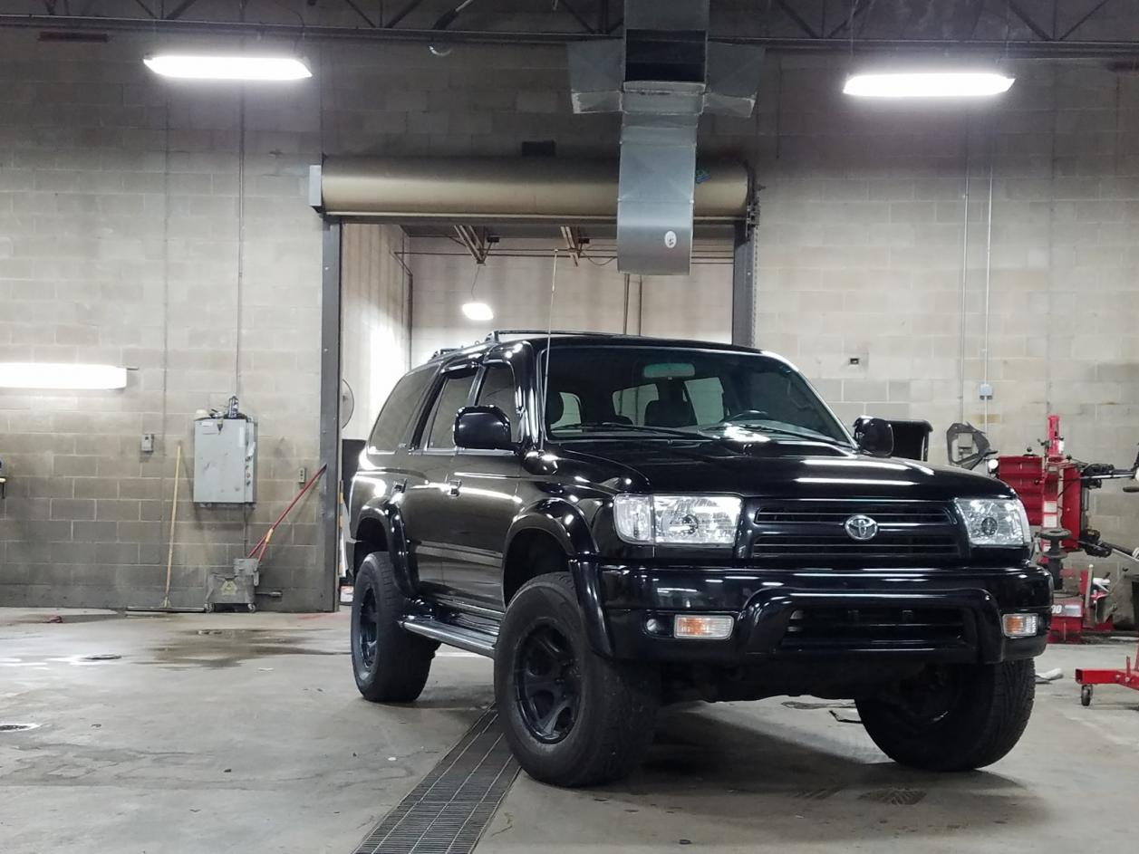

No I ended up selling the vehicle. The 3rd gen wasnt quite big enough for my needs.
