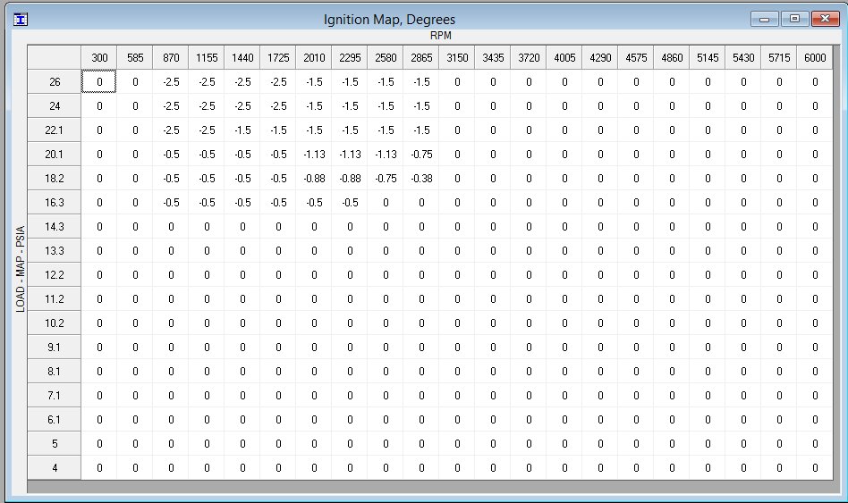

MTD your timing map pic still isn't working. I'd like to take a peek at it, I'm using a basemap for timing (1* per psi) still, but I'm not into boost yet since I don't have fuel for it.

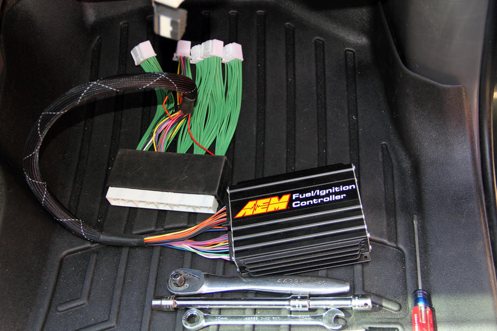

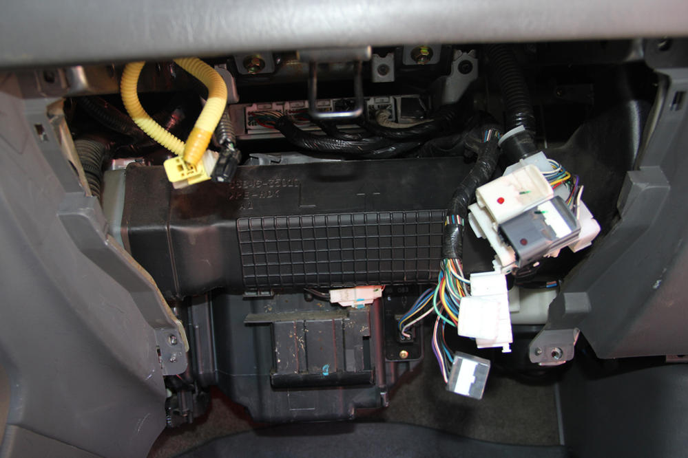

For those of you with a Boomslang and the AEM F/I C do you have any pictures of the way you installed them? There's NOT a lot of wiggle room in there. Also, where did you go through the firewall for the pressure lines and sensor connection for the UEGO Gauge and F/I C? Getting ready to do my install over the next week. Thanks.

I didn't use a harness so can't help you there but I went thru the ECU harness grommet on the firewall. You have to remove the two 10mm bolts to be able to properly get wires and hoses thru. My wideband and boost gauge wires/hose went thru a grommet on the driver side.

Thanks Drew. There's not a lot of room up there for the Boomslang. It looks like I will need to modify the glove box.
It will fit. It's a pain though. The best place I found is above the black plastic piece around the latch. If you put it there, about the only place to put the FIC is in the glove box.
I would definitely test everything out before you put it all back together. Their harness wouldn't work with mine.
