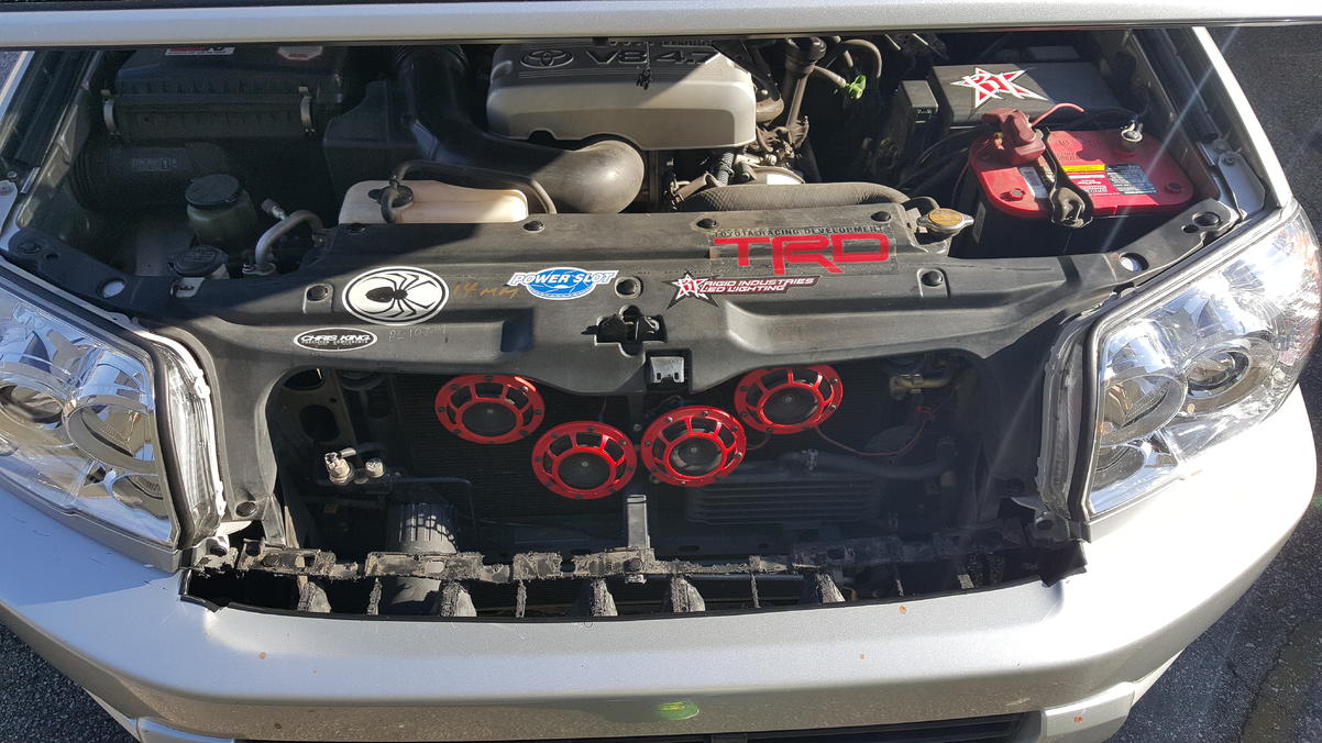

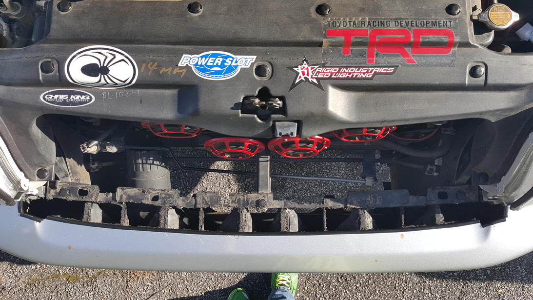

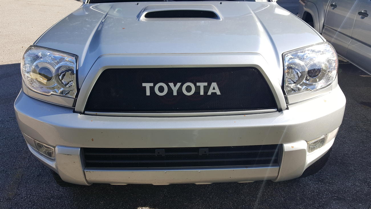

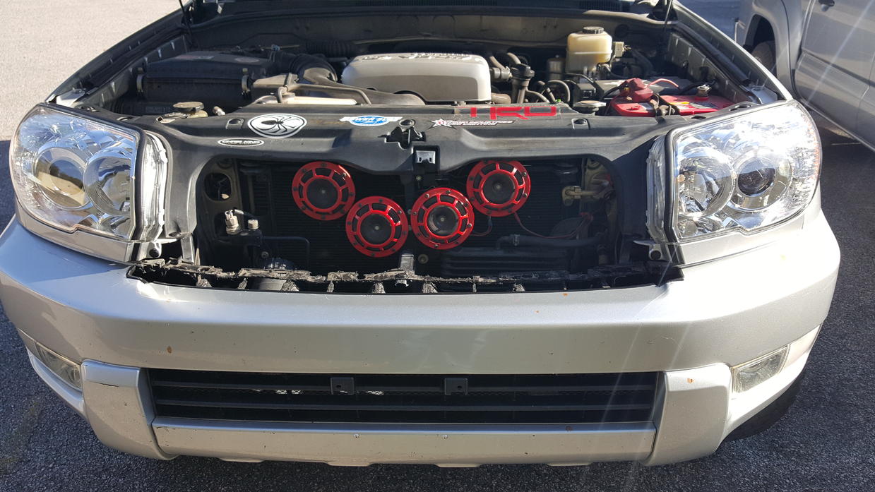

I just did this headlight swap and created my own wiring. And yes LED bulbs will have to be used, you do not want to create any electric gremlins within your vehicle. They can sometimes be impossible to fix.
With the 06 grill, you got to TRIM, TRIM, TRIM, unless you swap out with a metal bumper. Not to mention the latch bar to release the hood has to grow about 4 inches.

[MENTION=9463]HiVel-JR[/MENTION] .
your horns!!!!........u gat 4 lined up. what type of horns are those?..guess they sound good, got a link?..need some manly horns for my rav4
