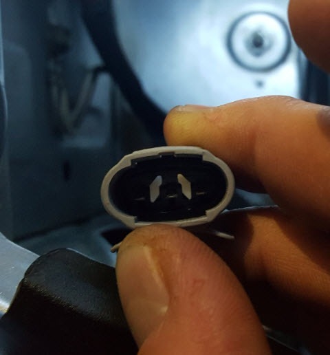

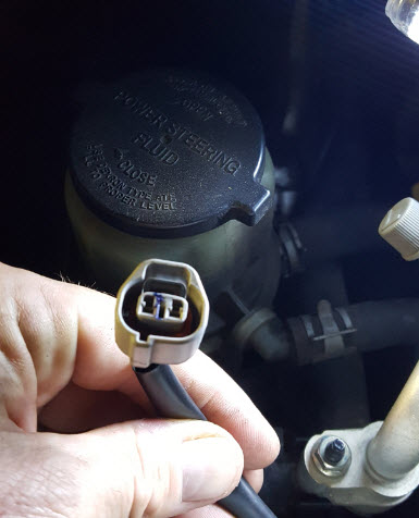

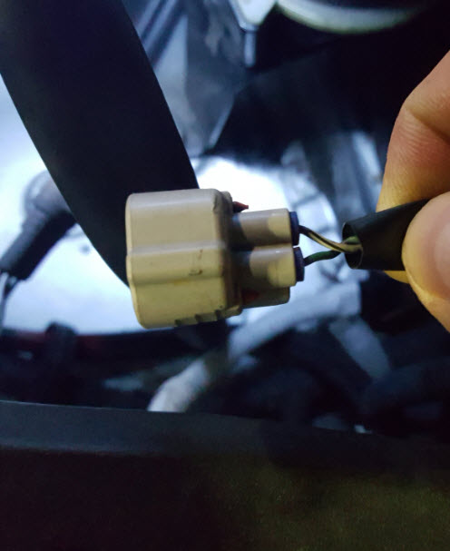

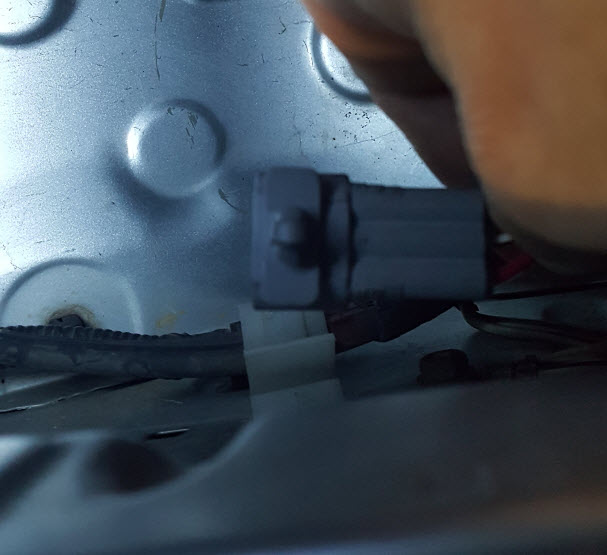

I did this mod back in October of 2015 and left the DRLs and parking lights alone, but i am thinking about connecting these lights up to see what they look like. (getting bored with no mods to do)
I saw your steps 9-21 where you connected the DRL lights and parking lights into the existing wiring, but i want to go a little different route and use the OEM connectors/harness and create a 4 inch long adapter between the two different type of connectors. (i know one is two wires and one is three wires so i will need to add power or a ground in the mix)
Do you or anyone know the part numbers for the pics below for the opposite end connectors/harness? From that i will create some type of adapter... i did see where someone found the wire connector/harness in a junkyard on a 92 Celica, wired things up, but could not find the part numbers.
Thanks in advance.

Not sure if it will make a difference but I just remembered that the original 2005, two wire connector/harness was for a bulb.
and the 06 wire connector/harness is for another harness to connect into.
At any rate, can anyone help?

I honestly have no clue what the part numbers are for those connectors. You might be able to look around on camelbaktoyota as they have some pretty good diagrams, but beyond that, I don't think I'll be any help. Sorry!
Actually you have been a big help, i looked around and it appears the best option is to just cut the ends off and solder things together, just like you did with steps 9 - 21 on your first page.
Good write up by the way.
