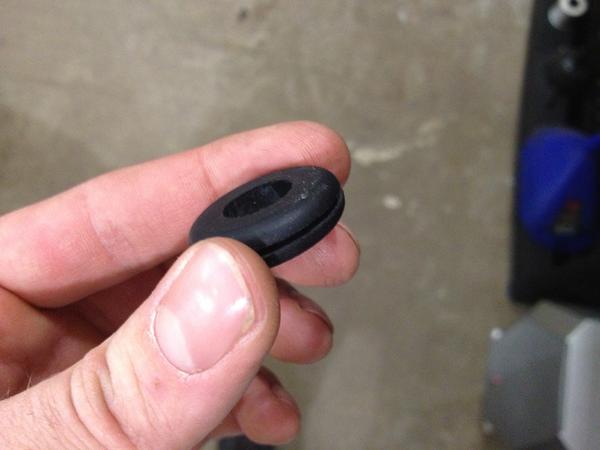

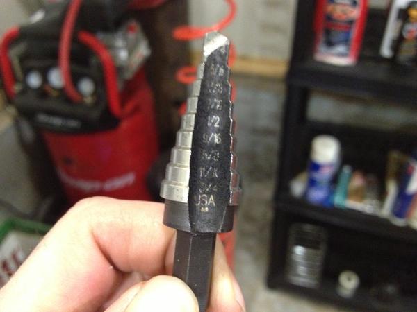

Something to open-up a hole:
4 rubber grommets of this type:
Pretty easy to do so I won't go into details:

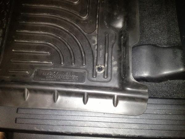

- First you have to find your hooks location. I placed the husky liners over the hooks and pressed firmly. That left light footprints on the liners. Do that after having fitted your liners well in their locations. Use your feet.
- Take your OEM carpet and carefully place it on your footprints, that will assure a good pitch distance between the two holes
- use the center of your OEM carpet hook's hole and drill. Firstly use a very small bit and go up in size progressively. Do not use high speed as the plastic will melt and it gets kinda hard to deburr.

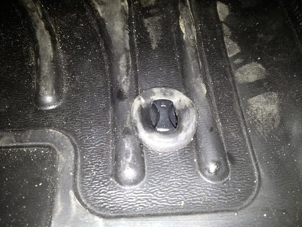

results:
Grommets and hooks are snug, so I used a bit of grease inside the grommet opening to ease application of the liners.

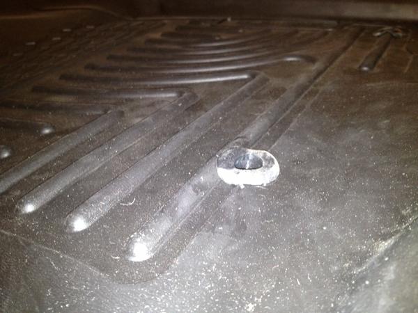

EDIT: close-up view of fitment
Did the hook design change from 2010? My hooks pulled up out of the carpet with a little effort, but without any damage. The one thing I really liked about he Huskies over the Weathertechs was that the Huskies didn't have a hole to accommodate the hooks. I was concerned that water from rain or snow would slosh around and down the hole, soaking the carpet underneath. Maybe I was being overly concerned.
Afaik it changed. Mine does not come off, and is a kind of twist mechanism. Causes the huskies to fit badly.
I have had weathertech and only very minimal amount of water (traces) got through the holes during the winter.

added close-up view of fitment. Hope this helps anyone in my situation (having bought husky's not fitting with the new design.
