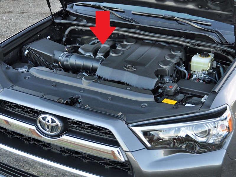

Where ever you store your OEM intake box and tube is where you will relocate the helmholtz resonator.
Seriously, look at the photos in this thread you will see no helmholtz resonator.
When you read thru the thread, you will read nothing about relocating the helmholtz resonator.
They are not used with the TRD CAI.
Hope this helps.
[MENTION=135616]991-GT3MJK[/MENTION],
I fixed it for you, cause it was hurting my head to look at it! :D
How did you connect the small tube it only reached the location of where the helmholtz resonator was? Sorry I am being so needy.
:confused:
I took my small nipple to the store and ended up purchasing 20" of 1/8" ID hose as it was a perfect fit!
Check your OEM vacuum hose for sizing!
