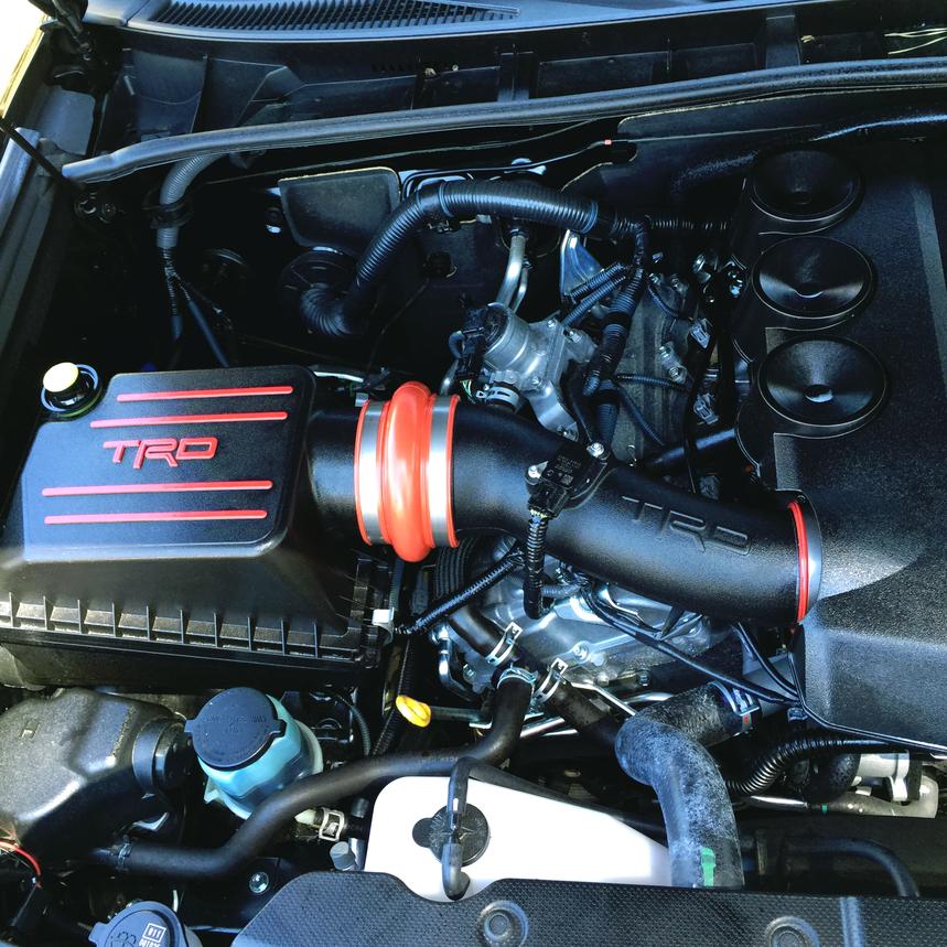

Time for installation!
Installed.
Major key to success - Silicone Spray Lubricant
Accelerator piece that sits inside the fender which must meet the bottom of the air box was difficult but managed to slip it on after using silicone lubricant.
Take your time removing the electrical tape for the MAF sensor.
Couplers for the throttle body were tough as well. They look like it won't fit but it will. I secured the coupler to the throttle body then attached the intake hose in after spraying lubricant. Then the other coupler then the top of the air box.
Other then that, she roars on full throttle. :cheers::cheers:
