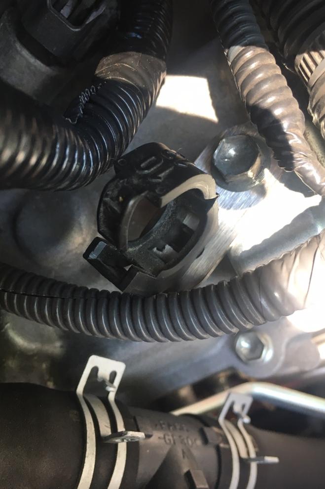

Step 16: Once the fenderwell tubing is installed, install the new airbox (bottom) in using the (3) bolts from the previous airbox. You'll notice a new 3rd hole location (inside) the airbox vice outside. Bolt down the box and reinstall the wire harness into the side of the airbox.
has anyone noticed that 1 of the 3 12mm bolts is too long and bottoms out before it gets to the grommet in the new lower airbox?
also what the heck is this thing for?.... i think it was in the bag with the rubber couplers and worm-gear clamps
sorry if these have been answered, i'm dirty and sweaty and don't want to scroll/read all the prior posts...

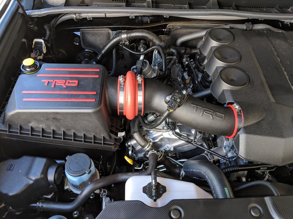

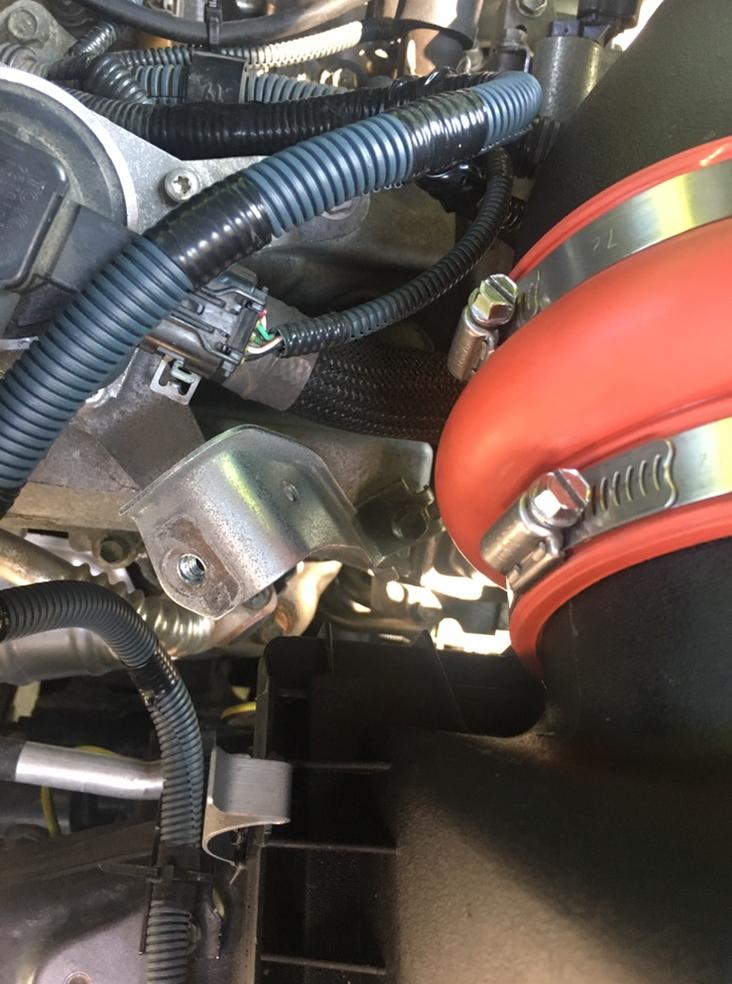

Thanks for all the write ups. I installed the CAI on my 2018 TRD Offroad without any issues.

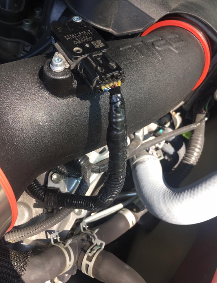

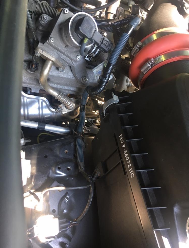

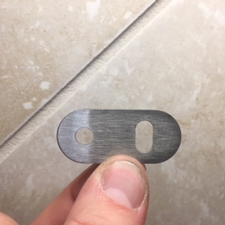

1. I have found good use for the elongated metal wire harness bracket. Installed it on top of engine as shown on Fig 3-1 of official install guide, then removed the plastic wire support clip from old intake manifold cover and pressed into the metal bracket’s slotted hole.
2. Instead of completely removing the resonator bracket I rotated it to provide support for the excess wire harness (ran zip tie thru threaded hole on top).

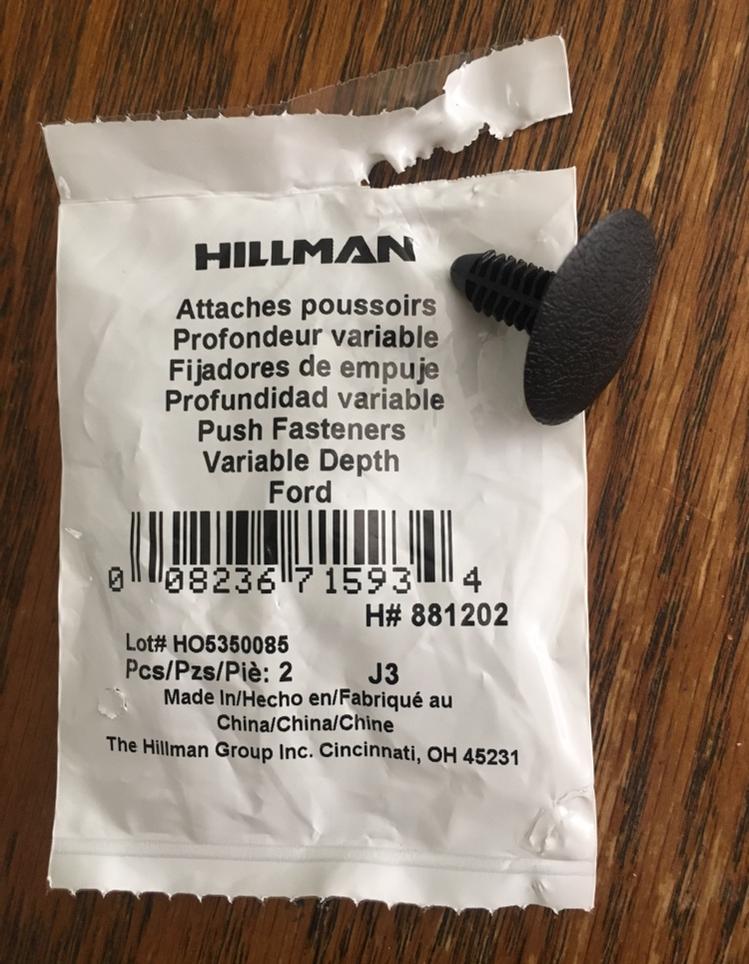

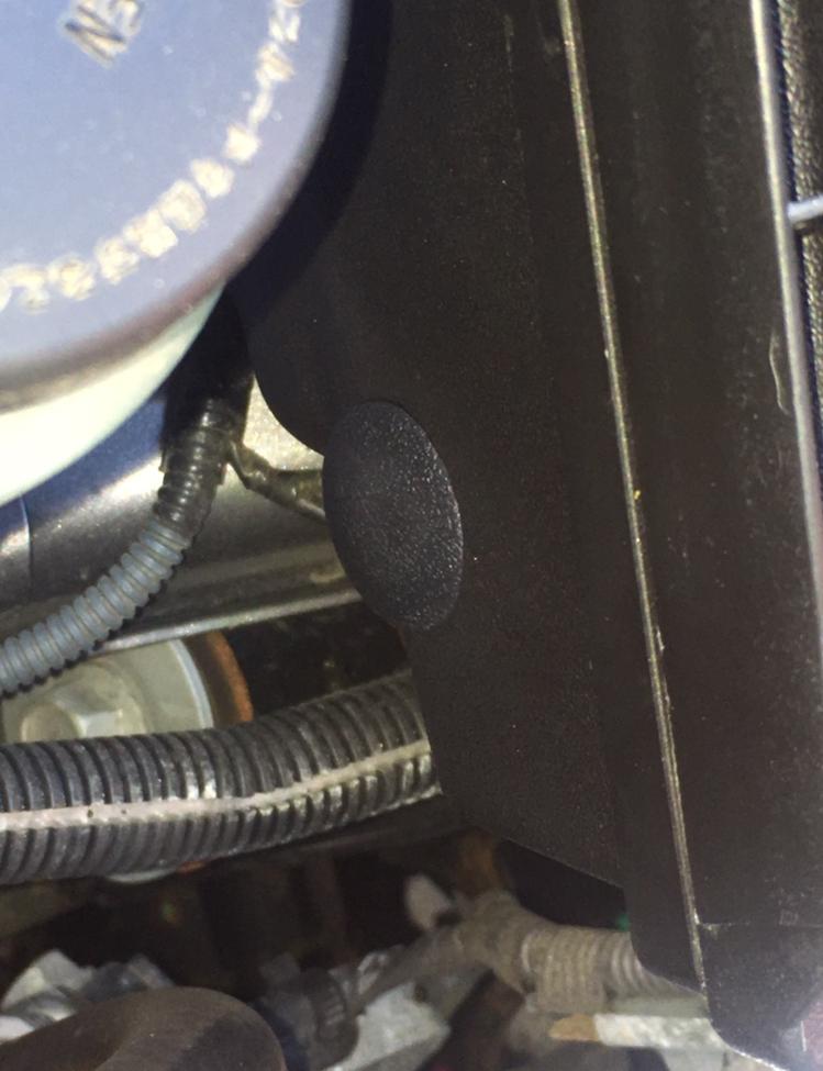

3. I tried multiple plugs from Lowe’s, part# 881202 was the best fit. The head is a bit too large but at least the surface pattern matches the intake housings’ and most importantly the ribbed body fits snug in the hole.
