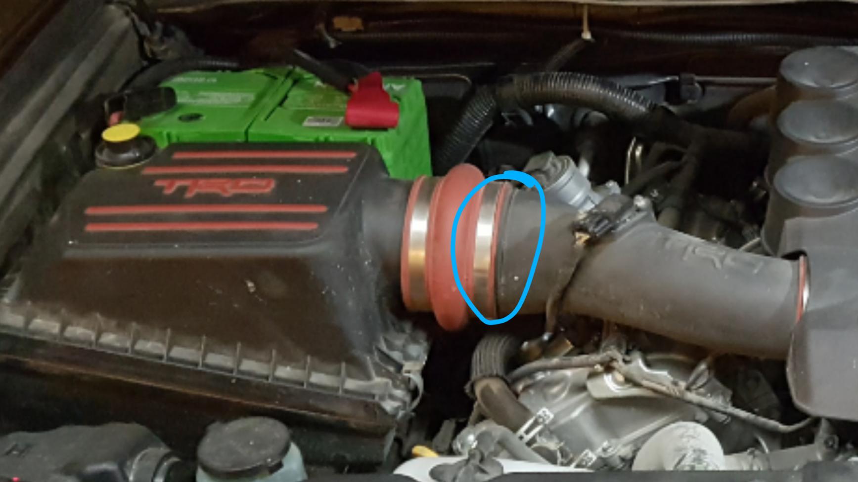

I mean this one circled in blue
I would also try to loosen the coupling at the throttle body, 2nd clamp from tb, to see if it would give you a little more wiggle room to move the TRD tube closer to the airbox, or at least to be able to adjust that angle to align it better into the airbox. You could also gain more coupling room from the air box by sliding the coupling down towards the tube. If all else fails my offer still stands, too many parts just sitting around
OK, no, mine could not come apart there if it wanted to. Your box hasn't shifted too far towards the fender has it. I seem to recall that coupling that went through the fender wall had a lip or something that needed to pressed in and then pulled back?
But on mine, that bellows fitting was / is a tight fit. Be sure the box has a not moved too far left.

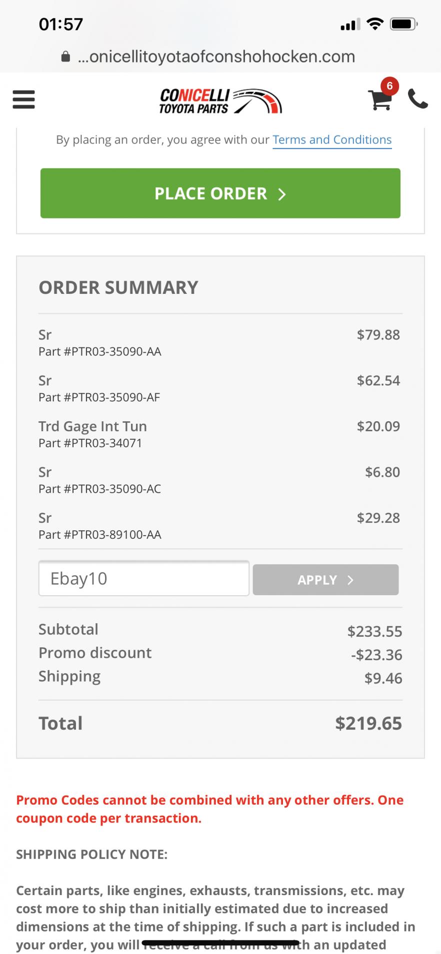

Thank you for this advise, the discount code still works. I guess even someone from Chicago is not all that bad after all. :caked:
Got all the above for $210 + $16 shipping.
The discount code still works!!
Just ordered everything to included the air filter for $315 including shipping!
Awesome savings!
:beer:
Still works, just ordered mine. Went with a K&N filter instead of the Toyota version. I may wait until I have to replace the paper filter.

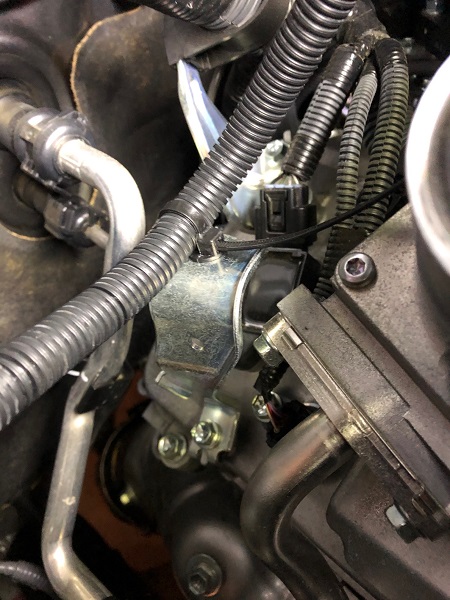

I just finished installing the TRD CAI. Fitment was easy even without silicon. One thing I ran into was securing the wires. The instructions indicated using the included tree zip ties but there didnt seen to be a suitable mounting location. The loom that the MAP wires came off on my truck (2017 pro) looked very different from the photo in the install guide. There was a small, two hole bracket that I mounted, that seems to do nothing at all?
I am not concerned about this...I can find a way to make them fast but was just wondering if anyone else ran into this issue.
I did search this but maybe not a carefully as I should have......
When Toyota moved the air pump, they put it on top of the valve cover, and it bolts to the spot where the instructions tell you to put the ziptie tree for the main wire bundle that the MAF sensor connects to.
I'm going to use the metal bracket that supported the air tube, moved to the back bolt hole on the valve cover and ziptie the wire bundle to that, and I will break the long leg from the plastic retainer that came off the old filter box, tape the bundle back to it, and clip it to the filter box. will look cleaner, and keep everything secure.

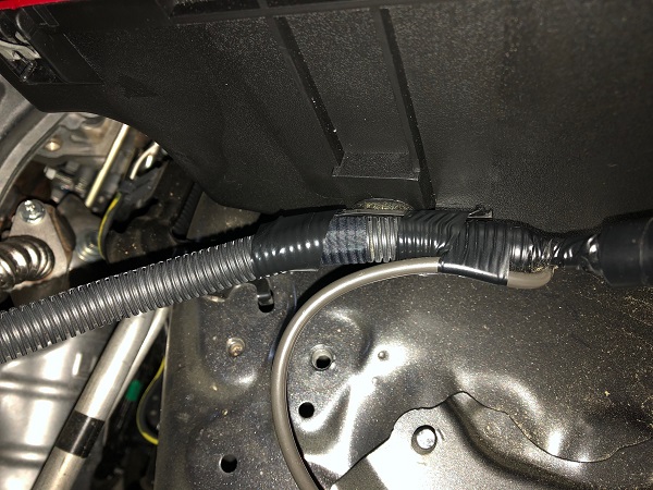

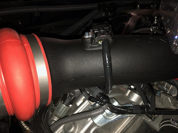

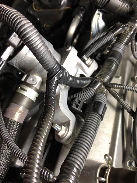

In case anyone is interested, this is how I did the wiring harness so it wasn't flopping around.
MAF harness routed under the air tube.
retaped wiring harness
Relocated the support bracket and used one of the zip ties with the tree on it to secure the harness. I did go back and tape the split loom and trim the zip tie tail.
Secured the harness to the airbox. At first I was going to use the L clip from the original air box, and snapped the lower leg off, but then I noticed there was a flat clip that wasn't connected to anything, so I relocated it to clip the wire harness to the new air box.
