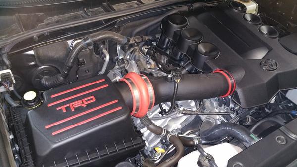

All in all, I think the TRD intake is an awesome addition. Also, since the pictures are not pulling from photo bucket in the first post, here is our full step by step install (TRD Intake Install 4Runner). Also the Magnaflow install: Magnaflow Install 5th Gen Runner

Installed mine tonight with the help from this thread. Piece of cake. I appreciate all before me who have contributed and happy I saved the money by parting it out instead of buying the kit. Definitely not as loud as I expected it to be from what some were saying about it. You notice a difference, but it's not dramatic by any means and in the lower RPMs it is almost like there is no change whatsoever.
