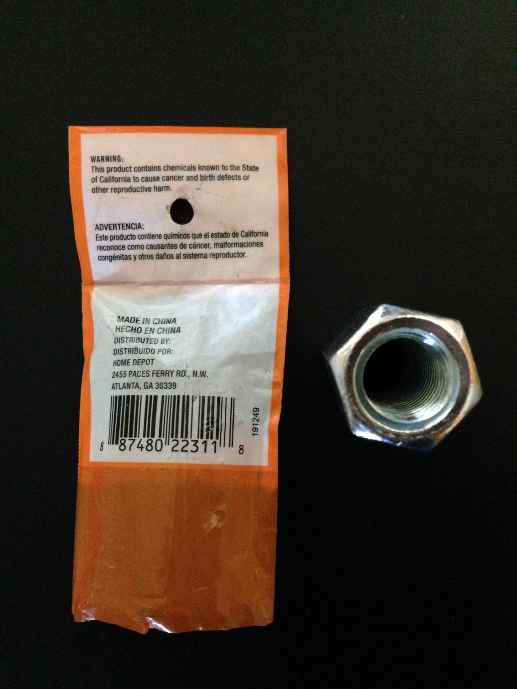

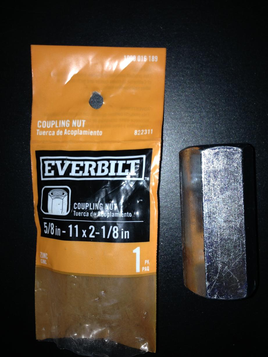

Help for those looking for the rod coupler

The 5/8" rod coupler worked great but I used a wrench on it because the socket wouldn't work without removing the sway bar.
I found the coupler at Home Depot with the steel rods, angle iron, etc. Below are pictures of the wrapper and receipt in case the part number/sku helps someone find it.
