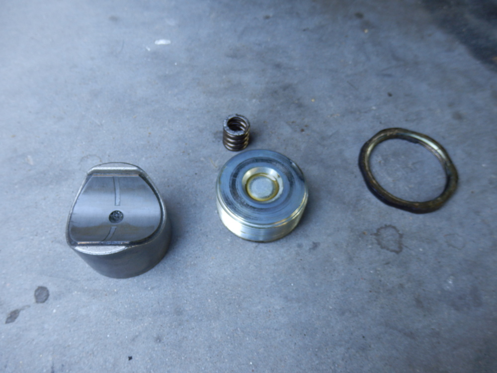

- At 240K miles on my 4runner, the guide had virtually ZERO wear. The actual mating surface is copper or brass with a coating, very similar to a crank or rod bearing. IMO with an 01-02, there is no need to buy replacement parts. I may change my opinion if I find wear in the wifes 02 tomorrow.

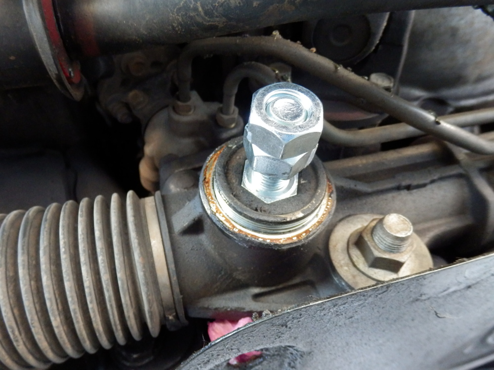

My little ghetto tool made from an M16 bolt and two M16 nuts. Head is a perfect fit.

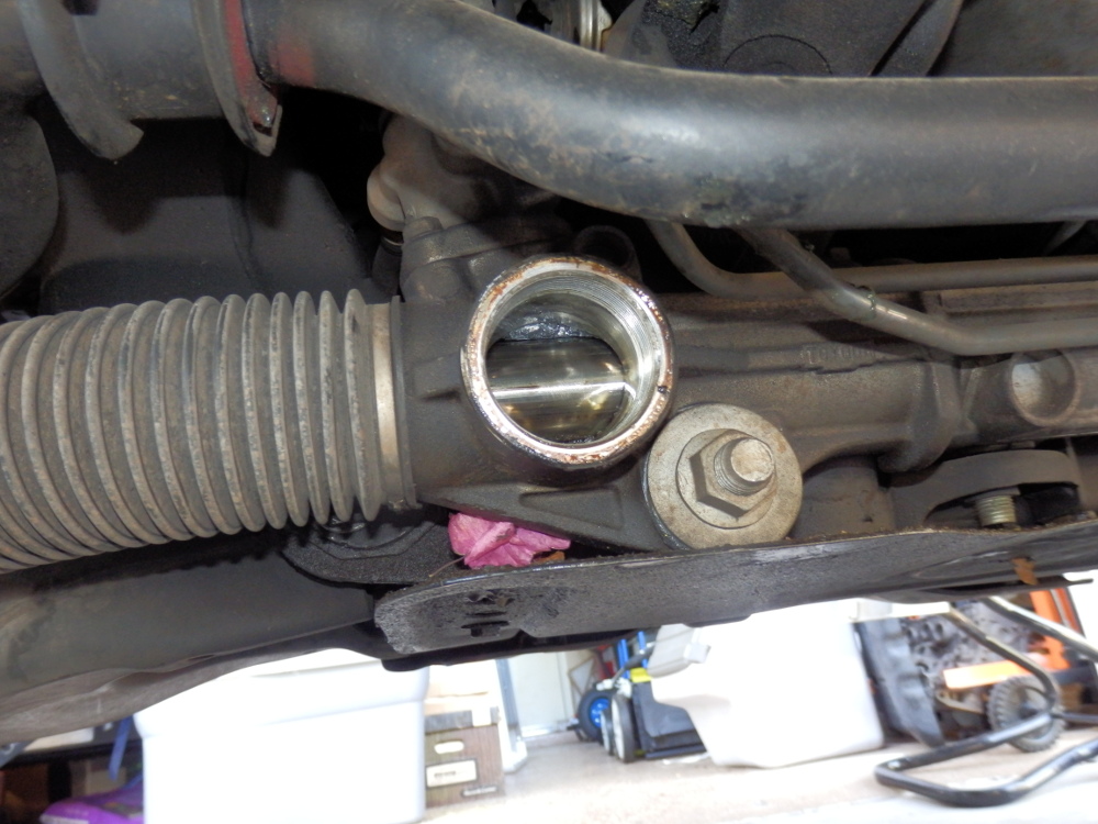

Guide Removed:
Guide at 240K miles:
