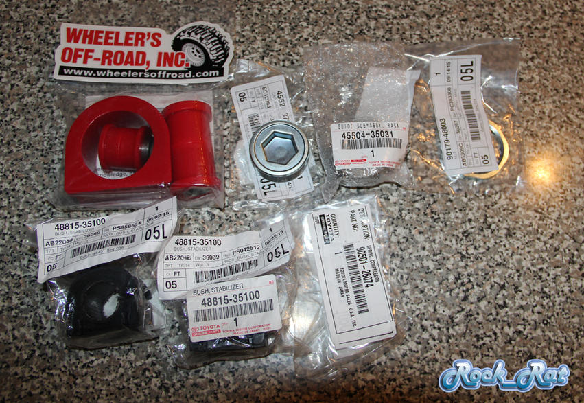

I'm surprised my bushings have lasted as long as they have. Figured it was time for some preventive maintenance before winter sets in. Thanks [MENTION=54671]yukonrider[/MENTION] (not sure if you're still around. Post was from 2010) for posting the parts breakdown and [MENTION=125884]AZRunnin[/MENTION] for the up close shot of the PN from home depot. Appreciate the input. New links from [MENTION=98153]MStudt[/MENTION] are also on my list of things to do in the future.
  • OEM for the Steering Rack guide and ancillary parts
  • OEM for the stabilizer bushings
  • Wheelers Off Road for the steering rack bushings
Hate to deviate from OEM but I'll give the Wheelers bushings a try. I haven't read any complaints about them on the forum. They're still in the bag so any negative inputs feel free to chime in.
