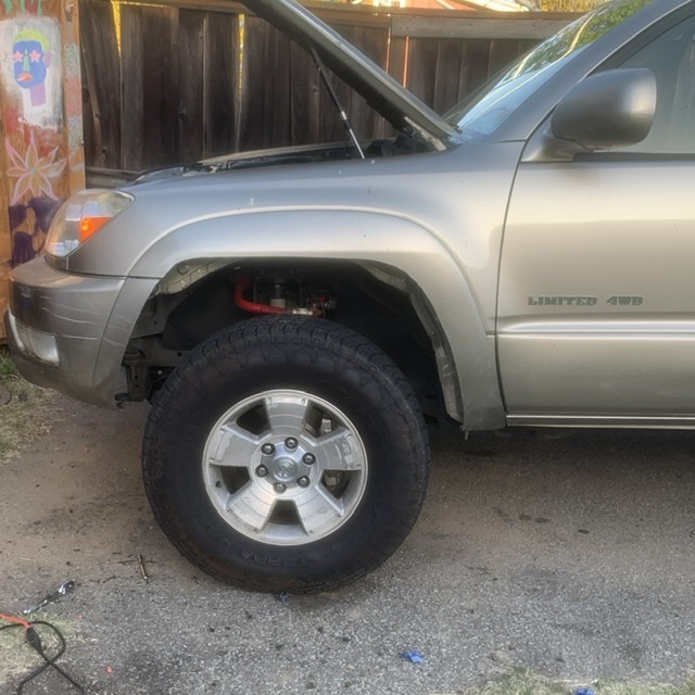

Resurrecting this one. Need to clean up the edges a little more and spray under where the fender liners were.
