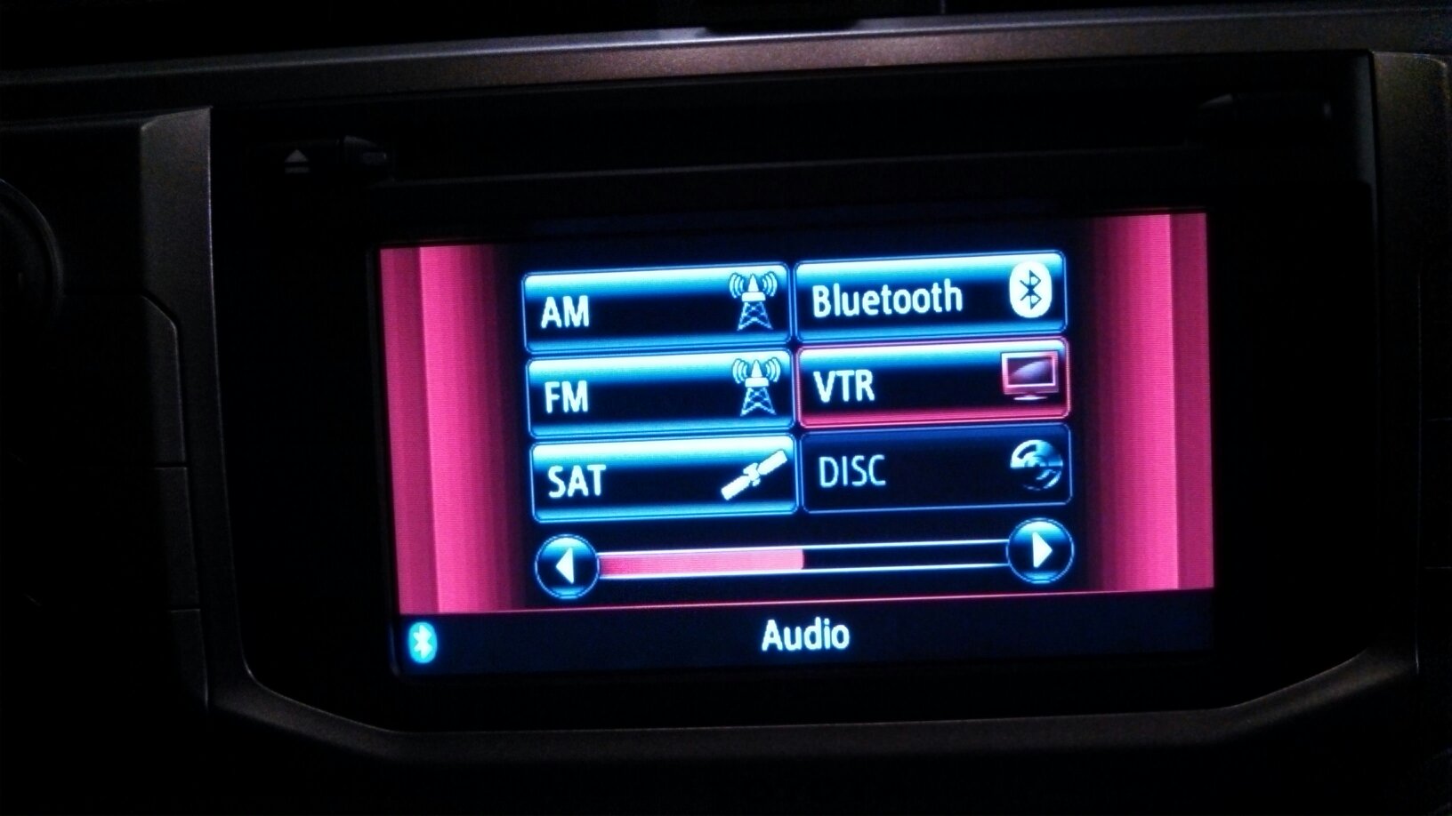

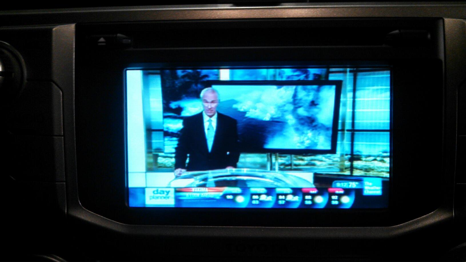

Yes I have done this on a 13 Entune, but I don't know if 14+ is exactly the same. I have a Xbox 360 pre-loaded with movies and games under the passenger seat and can view them on the Entune head unit (also displays on a tv in the rear) I can also mirror my phone or Ipad.
I did this awhile ago and remember it was quite complicated to make everything work right, and you will also have to bypass the motion lock out as well. I will dig into my bookmarks/research on my home computer to see if I can find everything that helped me. I posted this at the time, and nobody even seemed interested.
Here is the only two pics I have to show you the new option on the menu and it working.
How was your Xbox connected to the stock Entune? Via the AUX port?
What cable?

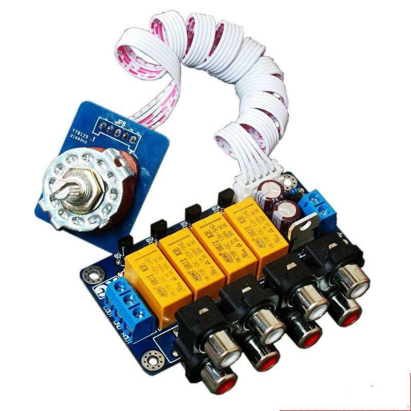

You can do the briguydiy dot com harness addition. It allows you to put in a button to show reverse camera at any time. I added a 4 way av switch to have 4 inputs. Front camera, rear camera, widi adapter, and trailer camera. So, when driving you can push override button and the reverse camera shows (can check on hitch), or you can switch the 4 way available switch to change head screen to front camera, widi of smartphone, etc. The widi shows what ever is on phone, and audio goes in via the auxiliary port. You thus can use Google maps, movies, Internet, etc. I really don't use this setup when driving except for navigation once in a while since I hate the navigation interface of the 4runner. Lots of 4runner owners are doing similar extra camera mods although I didn't see any others using the widi extender.

What kind of video selector did you use? I'm looking at using one of these and mounting the rotary selector where the SOS button would be (to the right of the diff lock button on the overhead panel.)
