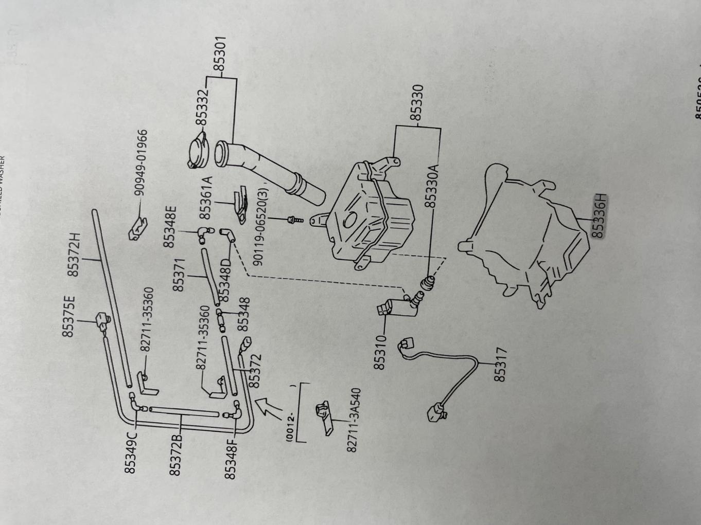

Never the less, while I have you, perhaps you may know. And idea where one might find the EV part number for the OEM wheel well plastics? I am looking for the black molding that protects the OEM wiper fluid tank from the wheel. I havent had any luck in the EV sites.

Thanks again, I was able to find the OEM PN finally. I ordered the replacement for part. Here is the diagram of that area. Located in the "Electronics" header within the Windshield Wiper items. Go figure.
