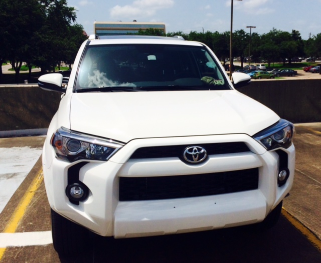

New to the 4runner world and just wanted to stop by and say hello. Have owned my 4runner for a week now and love it. Much better than my F150 and the MPGs I'm getting are putting a smile on my face.
Have a quick question though, I installed the Bilstein 5100s on my F150 to level it out and I liked the look but it road rougher than stock, not a big deal with my 4x4 pickup, I'm curious about y'alls experience with them on the 4runner though. I had them at the 1.75" on the front and it was noticeably rougher. I don't want my 4runner to ride too hard as it's a daily driver mostly on the highway. Houston roads aren't exactly stellar so I'd like to avoid a rough ride if it's possible, although I'd like to get rid of the nose dive cause its terrible.
Should I go with the 1.75" or 0.85" setup and if so will I need to put anything on the rear or just swap the struts?
Also any luck on a good tonneau cover? I really pushed to get the dealer to throw one in but with no luck. I really don't want to suck it up and pay the dealer but if it's my only option I may do it. I have to go back to get them to put the running boards and all weather mats in.
Finally, I'd really like black wheels without having to buy new wheels, anyone ever had their stock wheels powder coated in this area and have any good recommendations? I saw the write up from ANTMAN about painting his wheels so I was wondering if anyone had anymore experience in that realm?

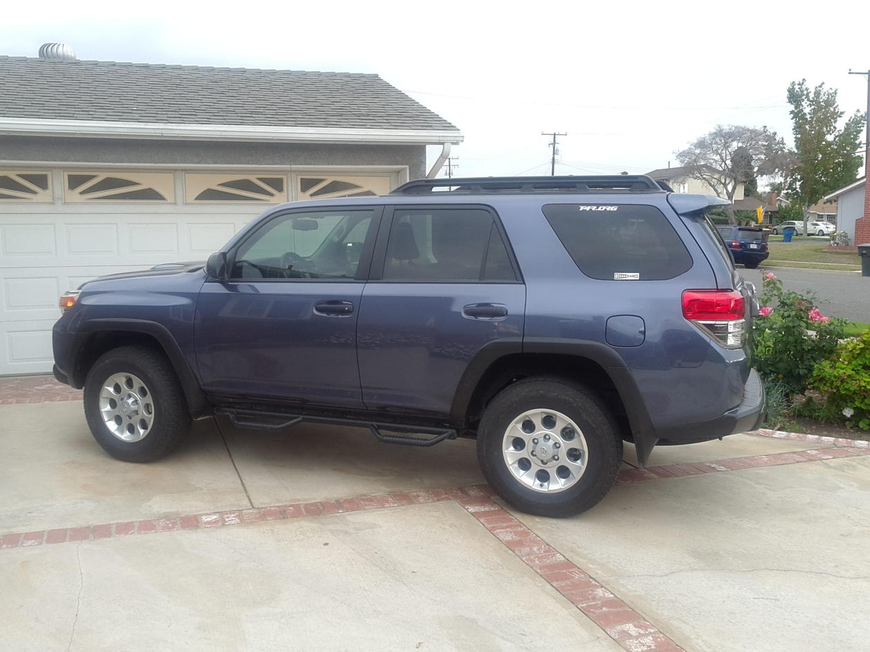

0.85 will get you close to level with a little tail high. 1.75 will give a good level. If you load it much it may go tail low at 1.75 unless you add Air LIft bags. I set mine to 0.85 as in the photo.
This is from on old post of mine, a search for Bilstein, level and lift will show more photos and input.
I set the front to 0.85 and noticed only a slight increase in firmness and reduced nose dive. I later added the rear Bilsteins and it does feel firmer but not enough to be a problem. It feels a lot more controlled off-road with 5100s on all 4.
