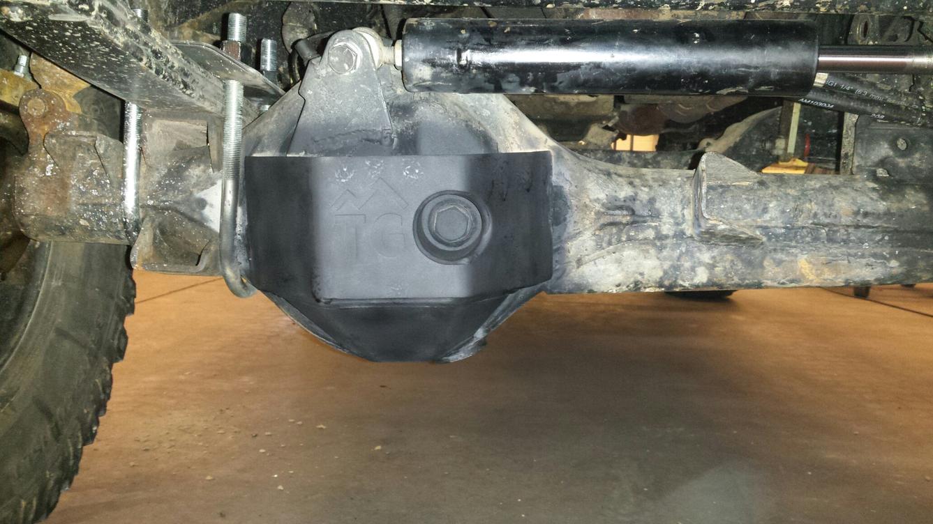

I got some TG diff armor and put a couple inches of weld on it for the ride at the flats. It will get cut off soon and replaced with a Barnes cover, because i'm really not very happy with my ram mount anyways.

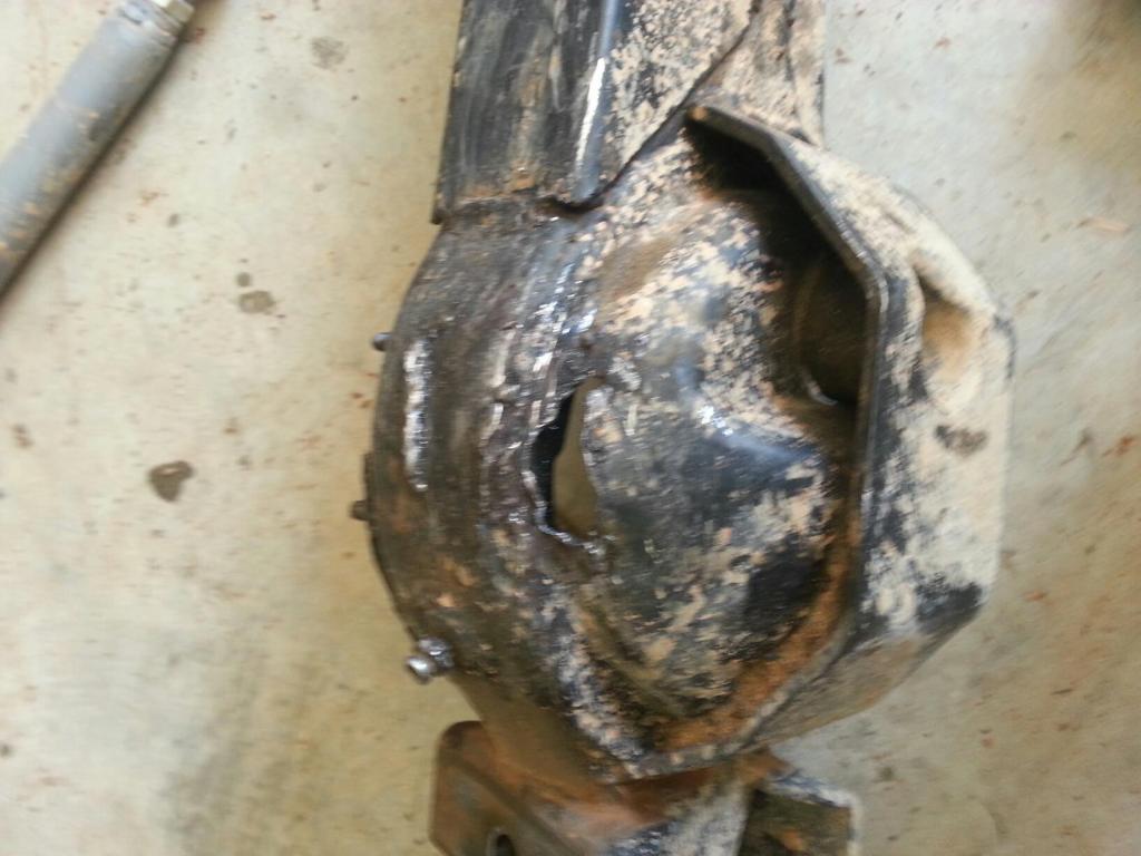

Yea I personally would not mount the ram like that, for fear of ripping that thin cover open.
Yep exactly what i'm scared of, saw this on a build thread on nc4x4
  • ai357.photobucket.com_albums_oo20_jrea42_Facebook_Mobile_20Upl567316f2c71585fea6e17b92dde9cc0e.jpg

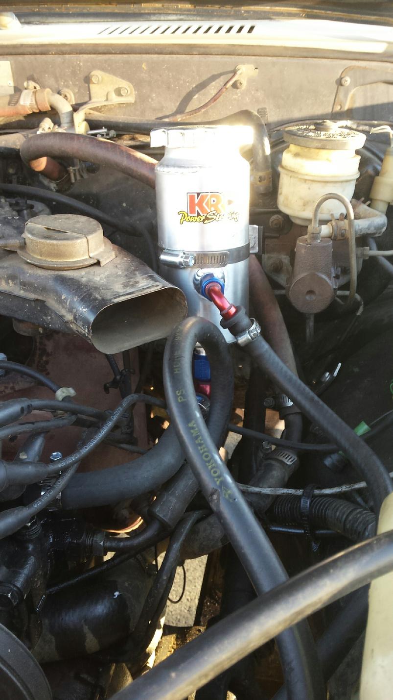

New PS reservoir mounted! and now my pump cavitation problems are gone.
I decided to go with a KRC reservoir, It saved me $20 over a TG reservoir. Also I like how the return line is lower since my ram raises and lowers the fluid level quite a bit.
