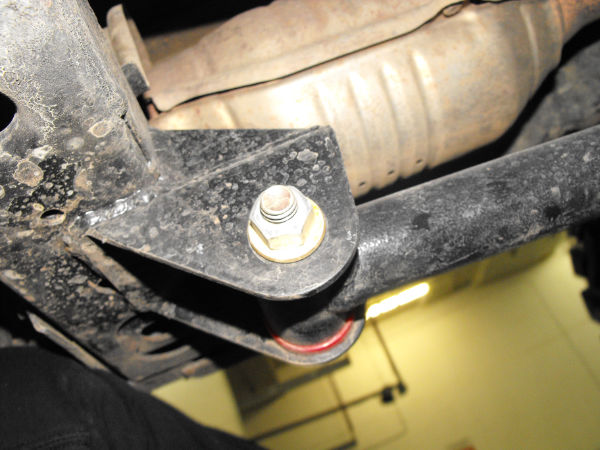

Current Suspension:

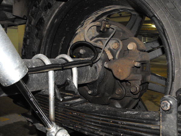

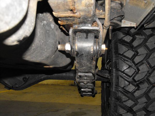

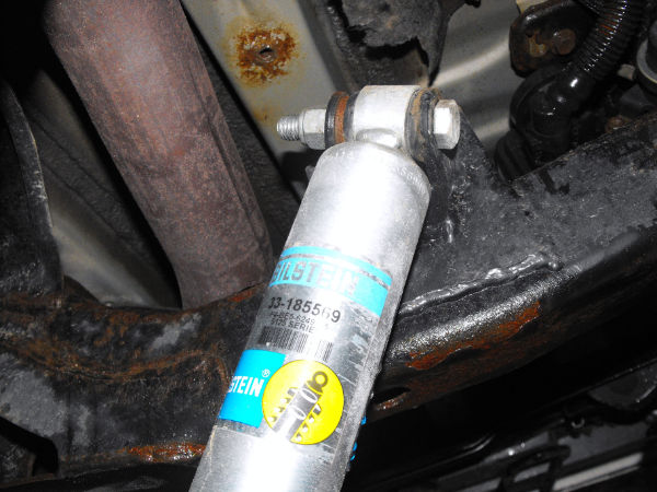

For the rear - Long travel Trail Gear leaf springs with bilstein 5100s. For the front, 6" Pro Comp adjustable coilovers designed for an FJ. Alot of work was done to make it all fit.

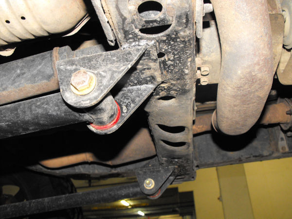

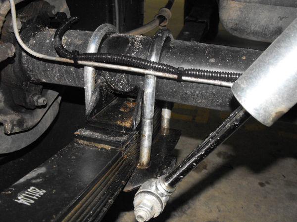

Here's the rear:
Bilstein 5100s upper bracket

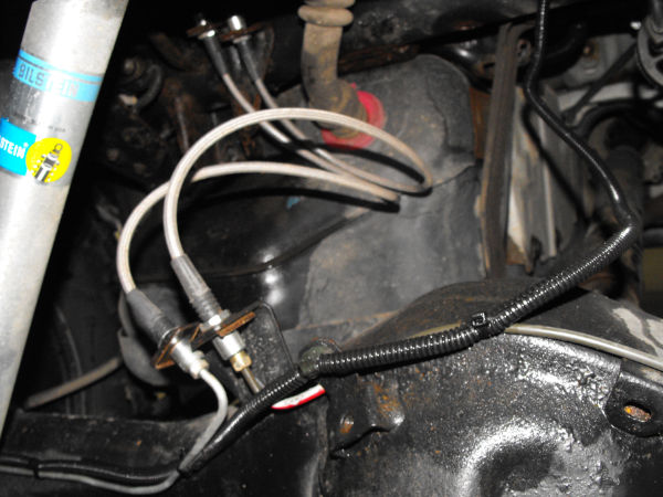

Lower mount, Naked axle on the leafs, abs and brake lines (left side)
Right side

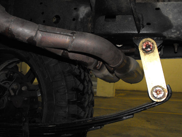

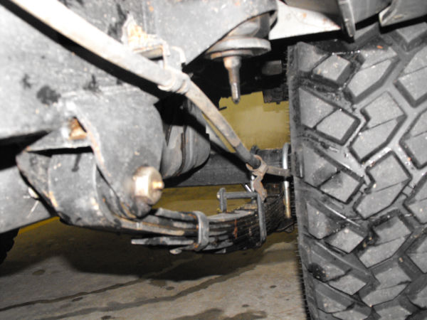

Magnaflowcat back, tweaked to fit above the leaf spring
The leaf (left side)
New brake lines

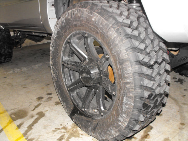

35x12.5.R20 Nitto Trail grappler on Iron Eagle wheels

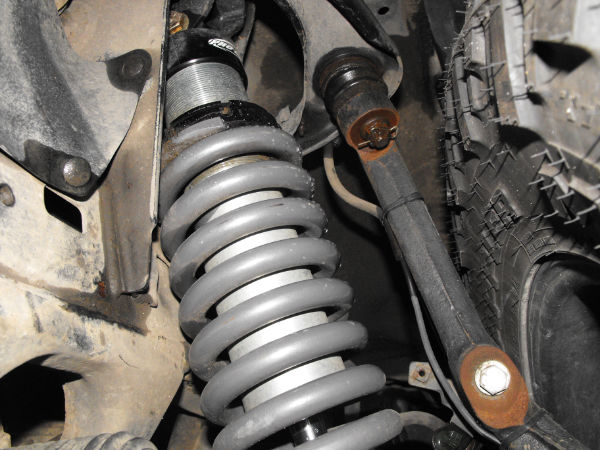

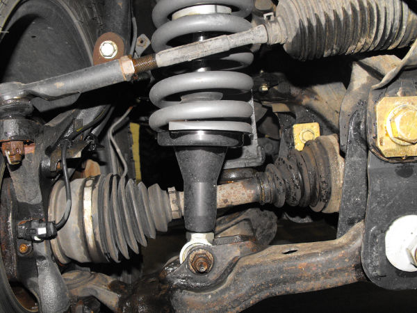

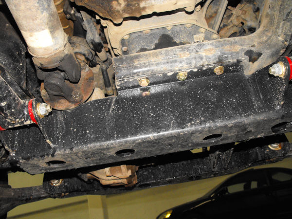

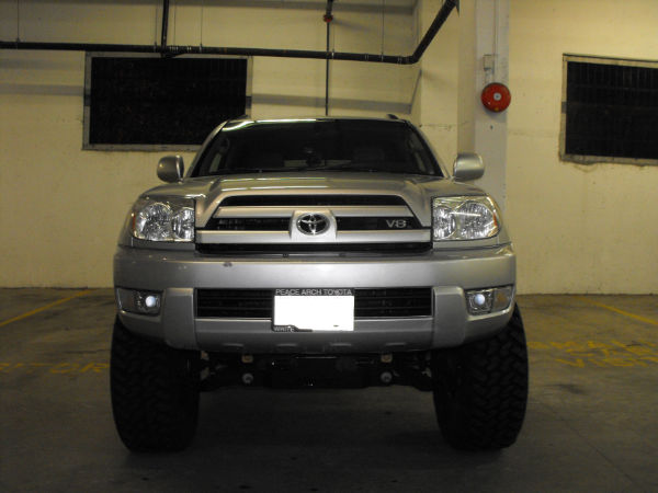

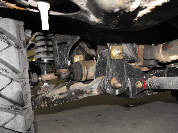

Here's the front...
Tomoro I plan to make the order to get my front Domello Bumper, ARB lockers/Compressor and Trail Gear sliders. May also get a seperate onboard air system just for tires and tools. Then off to the mountains to get her dirty again! More pics to come when I get time...

Wow. Very impressive!! What kind of exhaust are you running? I like the dual welded tips.
Its a magnaflow exhaust, shortened by a few inches as it supposed to come out where the shackle is mounted to the frame.

Nice custom work on the rear leaf swap, it looks very clean to be custom tabbed.
I'm surprised you didn't just go ahead and SAS the front with all that extra work
It was a thought, and I will get there enventually. Its a long term project and as it is now there are no drive or steering extensions. Once I am fully preped for the SAS it will happen then I'll be sittin on 37s.

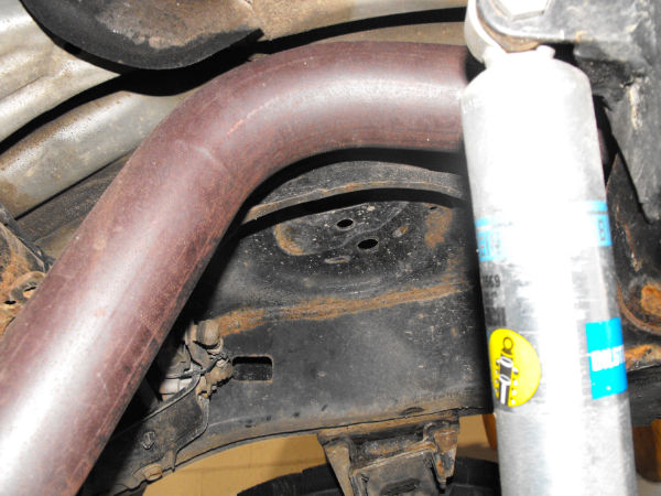

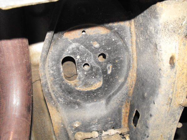

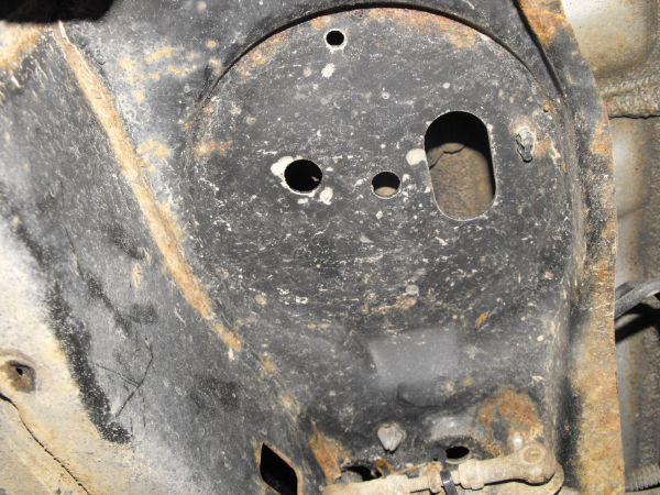

Just a couple pics as I have been asked how the original RAS chassis mounts look.
Here's the right side looking straight up at it
Again, the right side to show the depth of it
And the left side

Thanks for those pics, really helps!! Do you happen to have any pics of the lower mounts?
Truck is looking great btw. How do you like those tires (on and off road)?
Sorry, lower mounts are in the garbage, but its prety much a small plate raised off the axle an inch or so with one half inch hole in the center for the airbag to lock into, its visible on the right side of your T4R if you crawl under. Left side is covered with sway bar mountings and so on. The gap between the axle and the mount is where the pin fits after its locked in place.
As for the tires - Fantastic offroad, onroad they are ok, a little noisy, and not the best in the rain but I`m overall very happy with them.

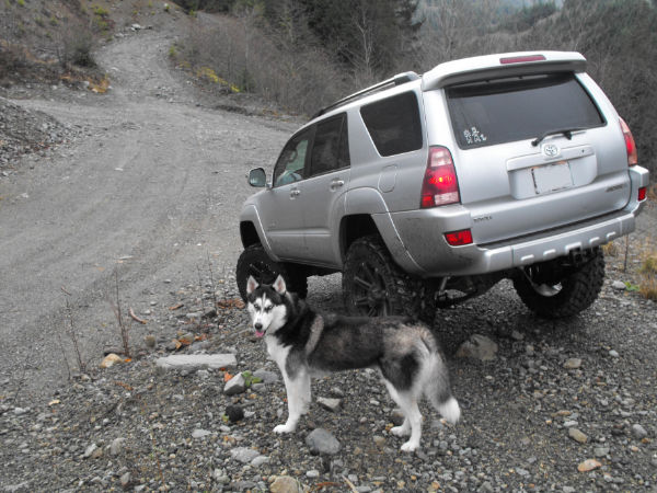

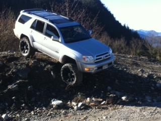

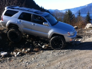

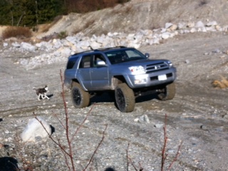

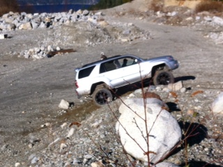

We took the dog for a run today...
After a little more trimming yesterday, no more rubbing at all :driving:

Thanks for the info. I've been considering those, but really want something with better on road characteristics. I was about to buy them until a recent thread made me start wondering if they were right for me. From reading your post, I now know they aren't what I need.
