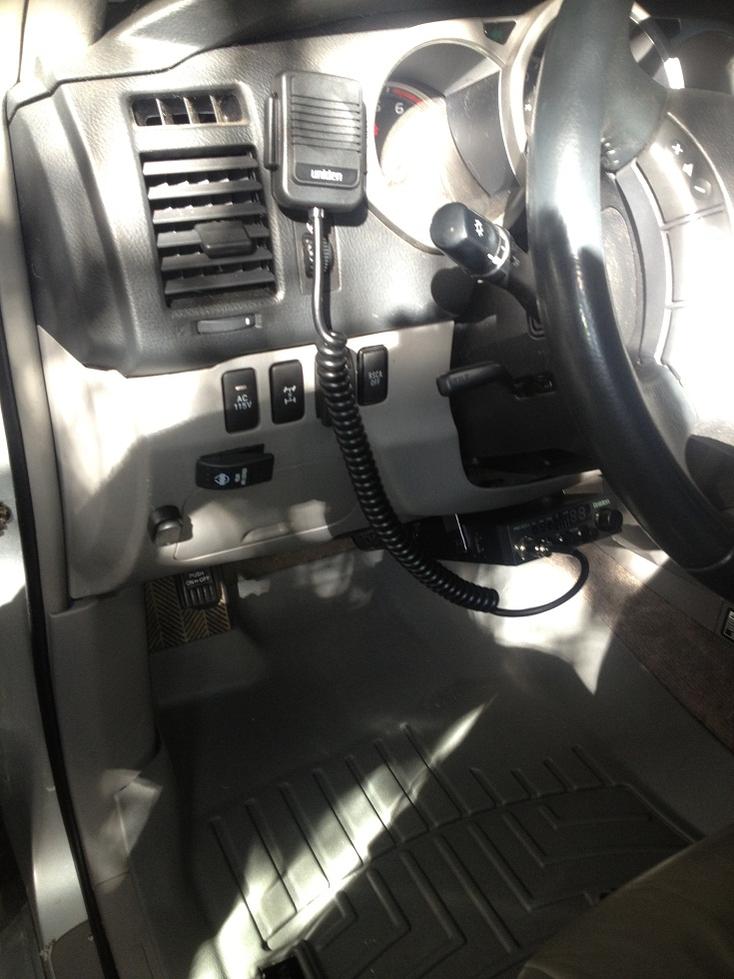

Here's a few more pics, mainly the radio install with a few other pics of whatever I thought worthy of this thread:

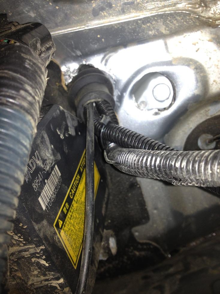

Here's the two holes I made throught the fire wall for all my wires. The unused hole on the right was done as it was an easier angle to get the drill at it however there is a steel plate behind it (unseen from inside the cabin) for part of the parking brake support. Anyhow, the hole I used was made with many small holes, pliers and a file - its not pretty but it works.

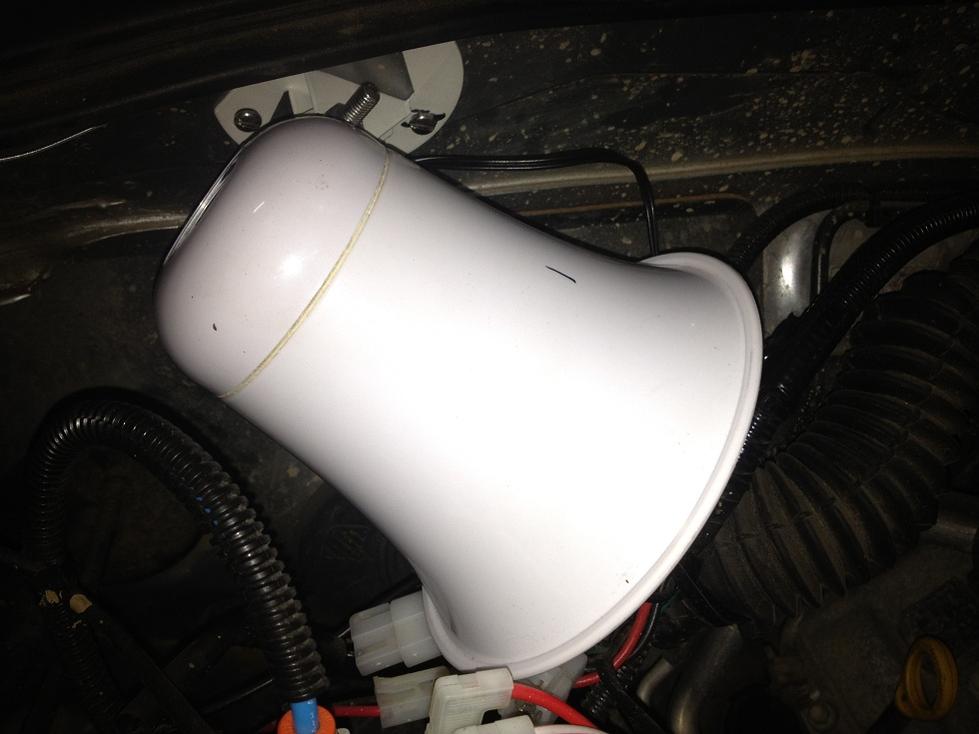

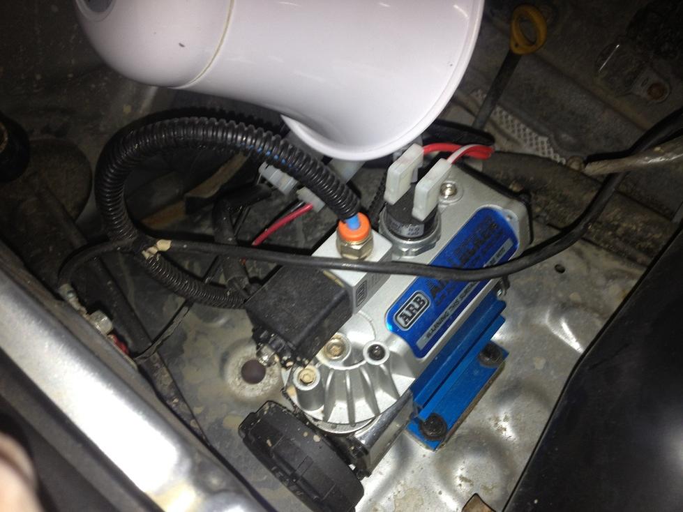

This was basically the only place left to install the speaker for talking to the dog.
Below the speaker is where the compressor sits for the rear diff locker
Here's where the radio sits, had no choice as the antenna cable just barely made it to here. The switch to the left of the fuse box opening is for the KC, the switch hidden behind the Uniden cable is for the compressor and the the horisontal switch is for the rear locker.
Almost forgot, got me some beauty floor liners!

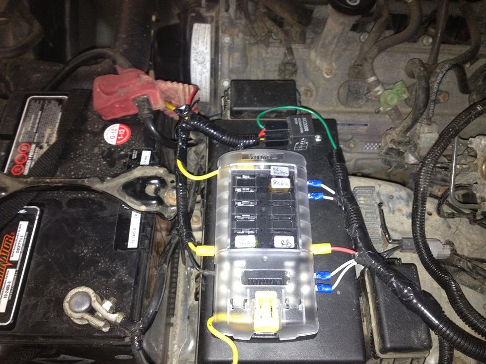

Here's my attemp to tidy up the wireing under the hood, actually it made a huge difference to install a secondary fuse box - and yes, i left enough space to get into the existing fuse box!

you should watch out with the cb. had it mounted in the same location, got in an accident and it took my knee and knee cap OUT. just my 2 cents.
